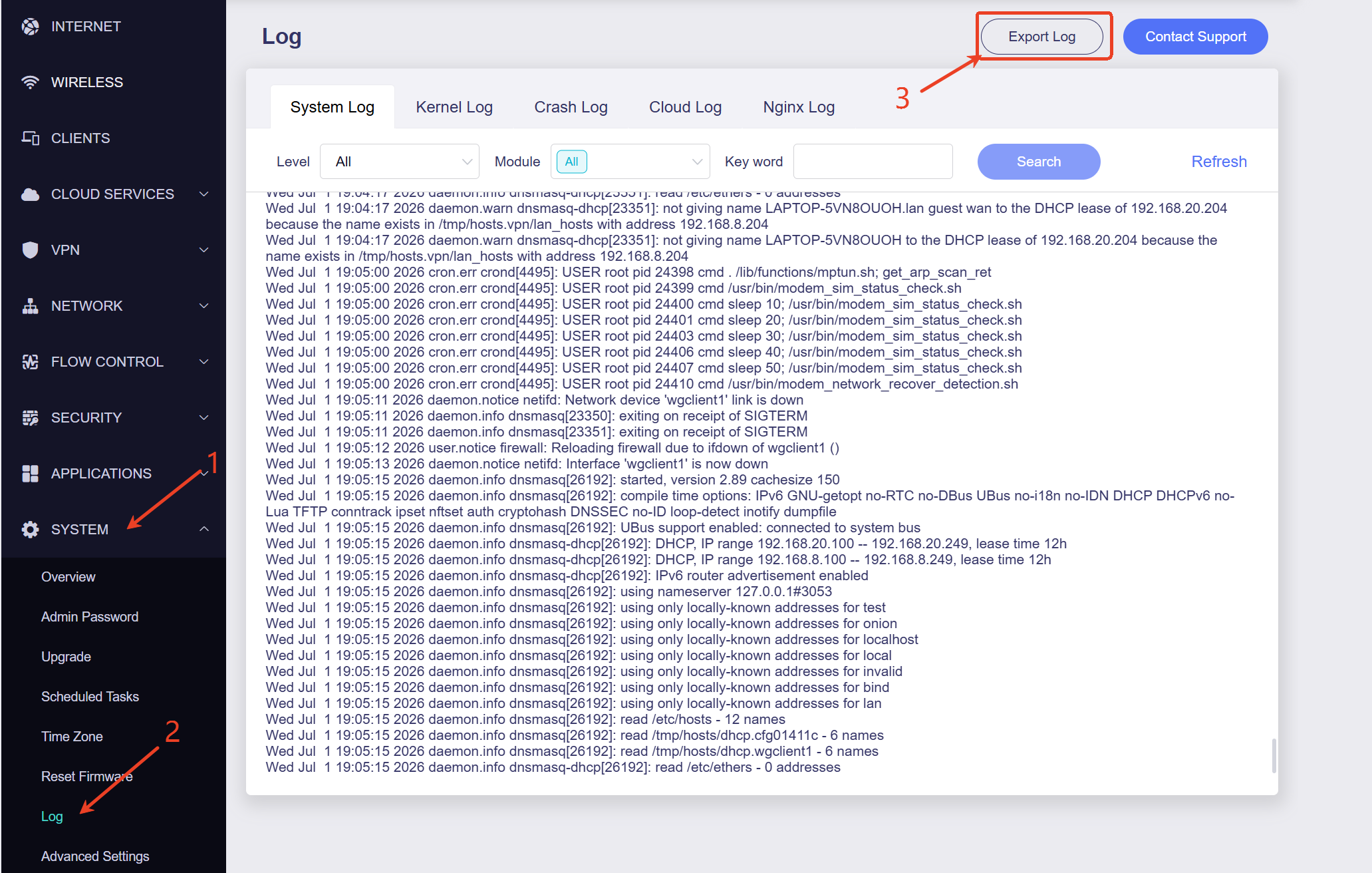

After that, please send us the command results and the exported logs via private message.
