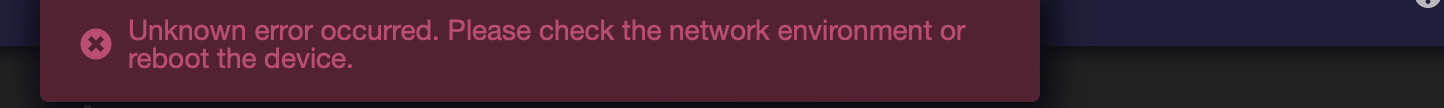

Unknown error occurred. Any suggestion?
It's actually two issues. Not sure if they are related.
Just got the Flint2. Connected as repeater to test out. Upgraded to latest firmware (v4.6.4) once internet is connected. Added a conf file from Windscribe VPN and configured to use policy based by client devices. Then I noticed the 'Unknown error' message started to pop up at the top. At that time, everything seems to be working. VPN and Non-VPN devices are getting the internet with correct external IP addresses. So I ignored the error.
After a day of usage, I restarted one of 'VPN allowed' Windows devices. Then that device couldn't get online anymore, even it's connected to the router. I tried anything I could think of (turn off VPN, remove all devices in VPN policy, use global proxy..etc) At the end, I decided to reset the firmware and start fresh. Still no luck. I can see the client device in GL's web UI, but traffic is not going thru. Even after router reset with no VPN profile.
This only happens to previously connected Windows devices thru Wifi (2G & 5G). If I connected thru wire, then it's fine. Because I used VPN policy based on client, I thought it's the MAC address saved somewhere in the router that caused the internet blocking. But it's still the same after firmware reset.
Also, the 'Unknow error' keeps on popping up every few minutes while I'm in the web UI. Even after I reset the router (only connected as repeater and no VPN profile), the error still shows up. I saw couple other threads with same error, but seems like they have additional packages or Luci installed. In my case, I don't have anything extra installed.
Any suggestion on what I can do next to troubleshoot these errors?
Thanks

Yes, I do see the same error message shows up on other sections of web UI.

Can you open the browser developer console (F12) and look if it print an error while the message is shown?
Yes, I see these.
It says the network connection was lost. So it is a problem of the connection, not the router's UI and API.
Maybe you windows disconnected from the router's wifi.
After opening using F12
You can see which rpc is red
Click Payload to see which API it is
