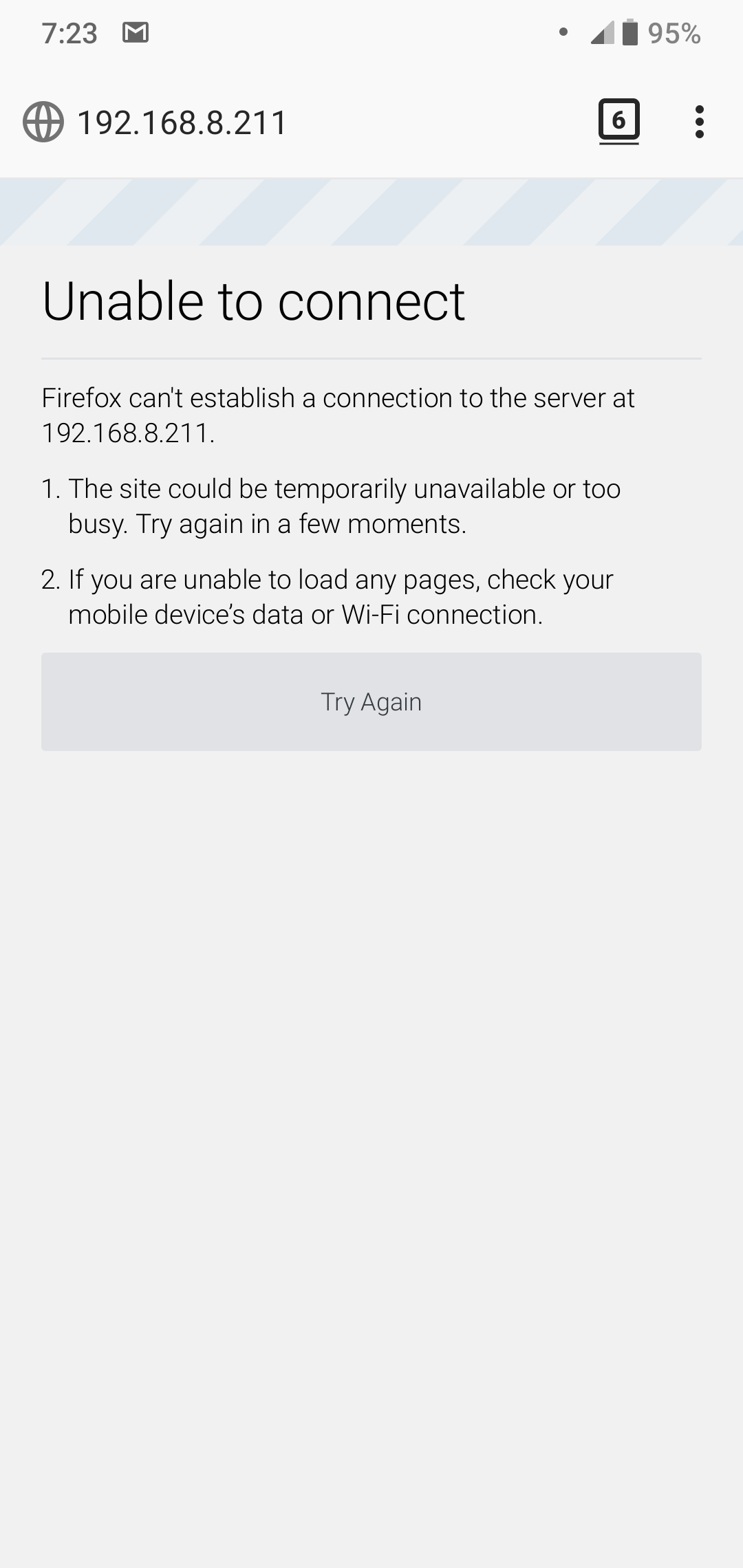

Ahh, made the assumption that because it was a slave node I couldn’t access the web interface :frowning:
I can ping it, SSH and scp to it but…
Do I have two problems?
  1. Master not upgrading slave
    2 No web interface on slave

I don’t believe the master node will update the slave automatically it would need to be manual.
You should be able to access the web interface of the slave, so you may have a firewall issue on the slave.
I would think you probably would be able to upgrade via SSH but I haven’t tried so can’t really say.

Got some time to play. I SSHed to the slave node, restarted uhttpd and now when I use the browser to point towards the node and I got the Luci interface. That’s one better. Did the 3.025 firmware update via Luci and all went well!
After a reboot now if I got to 192.168.8.2 (slave node), I get the Gl.Inet web interface but it tells me that the password or username is wrong?!? If I got to 192.168.8.2\cgi-bin\luci I get the Luci interface which I can log into with my standard password and the password also works for SSH and WinSCP sessions.
