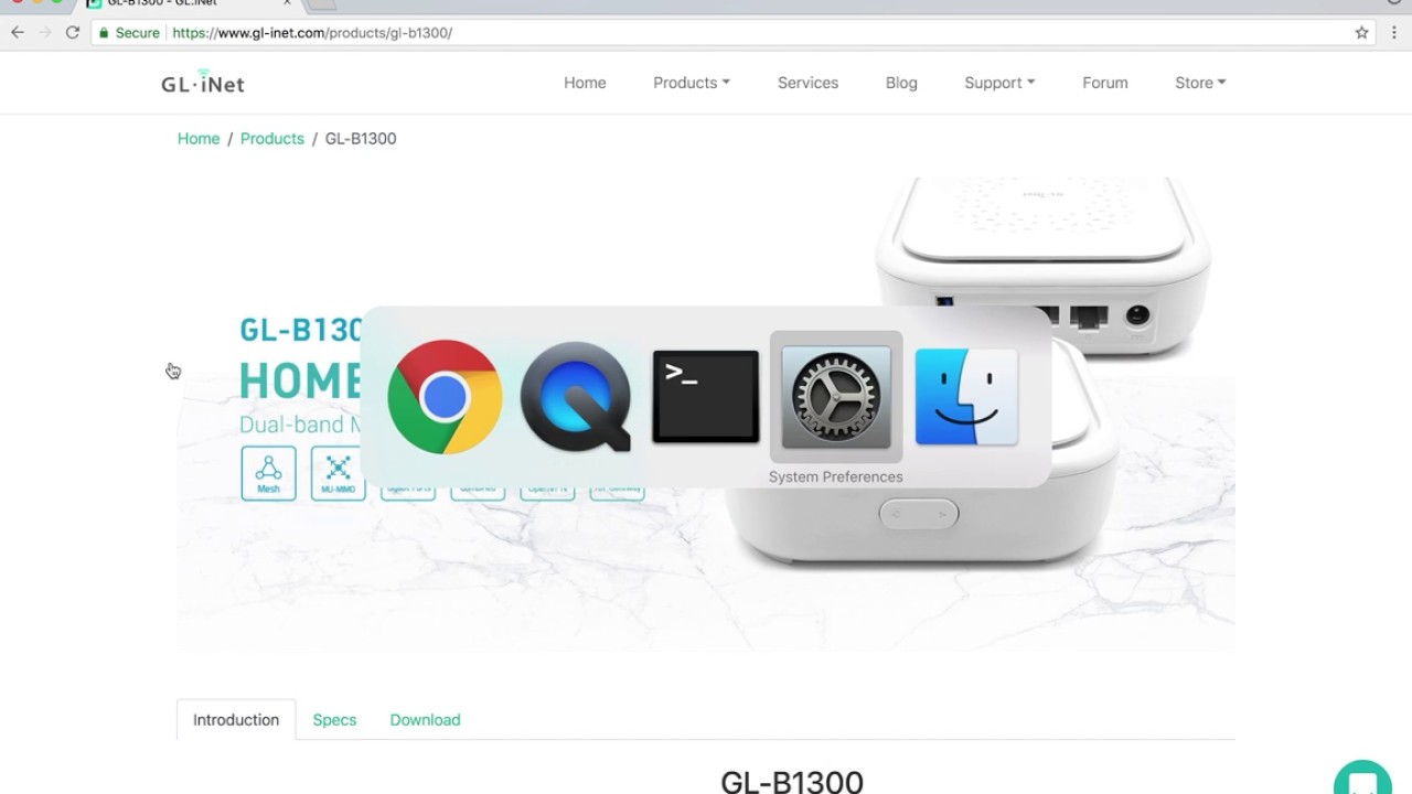

I used the TFTP method to flash stock OpenWrt, this video explains how to do it:
However I did it using a Debian laptop rather than a OSX machine, install and setup the TFTP server:
apt install tftpd-hpa
wget https://downloads.openwrt.org/releases/18.06.1/targets/ipq40xx/generic/openwrt-18.06.1-ipq40xx-glinet_gl-b1300-squashfs-sysupgrade.bin -O /srv/tftp/lede-gl-b1300.bin
Set the IP address of the Ethernet port on your machine to 192.168.1.2 and power cycle the router (I plugged the Ethernet cable into the middle port).
