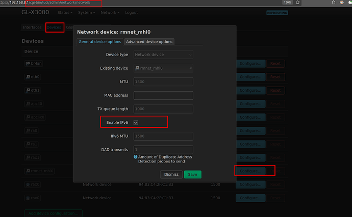

Anyway, to disable IPv6 for particular interface (e.g. the WAN), login into LuCi as per the screenshot below and uncheck the Enable IPv6 box:
Sorry for confusing.
I have two issues. One is for the speed slowness. Another is my work vpn can not be used when ipv6 is enabled.
Thanks! I will try to diable the ipv6 first.
