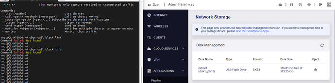

3. Ubus Status Check:
root@GL-MT6000:~# ubus call block list
Command failed: Not found

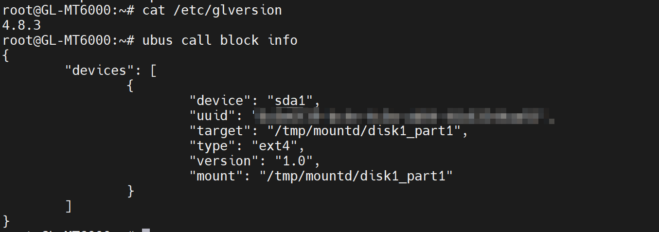

I’m not entirely sure what “Device Management” feature you’re referring to.
However, ubus block is provided by blockd, and we do not include it by default.
You can install it manually with the following command:
opkg update && opkg install blockd
After that, you can check the relevant information with ubus call block info.

Could you please provide further details:
  1. Please share relevant screenshots of the issue so we may better understand the problem;
  2. What is the model of the USB storage device experiencing the issue?
  3. What steps need to be taken to resolve this issue?
