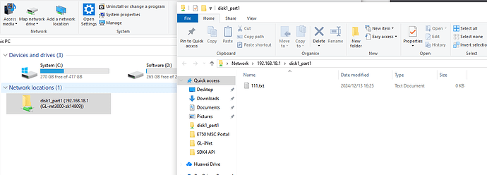

After formatting to ext4, it may be displayed as unavailable on Laptop. This is a problem with Windows OS. It is not compatible with ext4.
But the GL router (Linux OS) is compatible with ext4, and it is best format for Linux, so please insert the U-disk (ext4) to the GL router, and it can be automatically mounted by GL router.
And connect to the share folder of the router via the Samba/DLNA/Webdav on Windows, the U-disk can be read and write normal.
