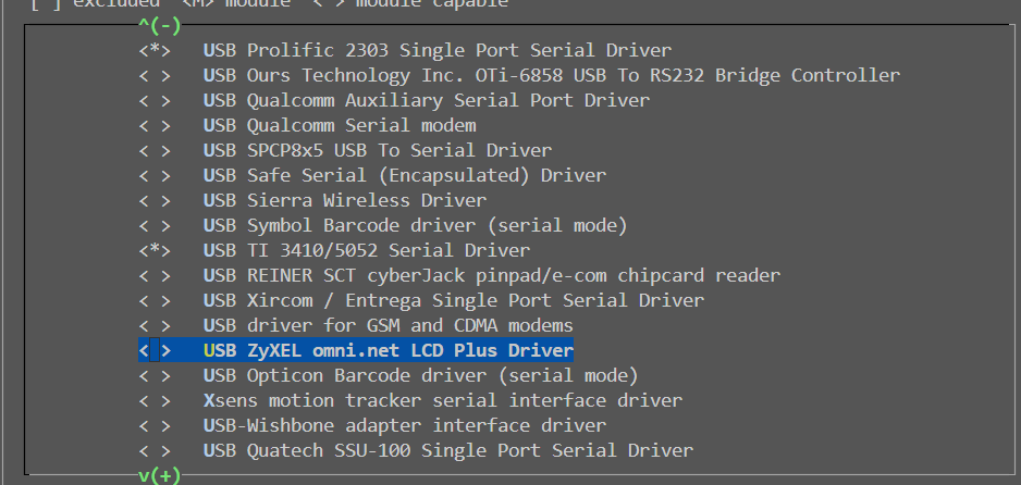

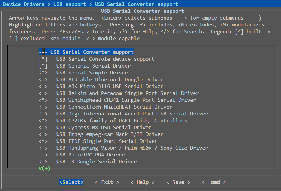

at least ch341 is supported
Glad you mentioned that — I’m actually looking at the Comet 5G, not the Pro. But yeah, the builtin modem is what sells it for me. The KVM functionality could actually be used sometimes, although rarely. I could probably do the same thing with any of their modems, assuming they also have the usb-serial drivers and Tailscale builtin.
Looks like FTDI is supported also, which is what most of the modern usb/serial adapters use and is the recommended ones to buy for most people anyway :ok_hand:t2:
