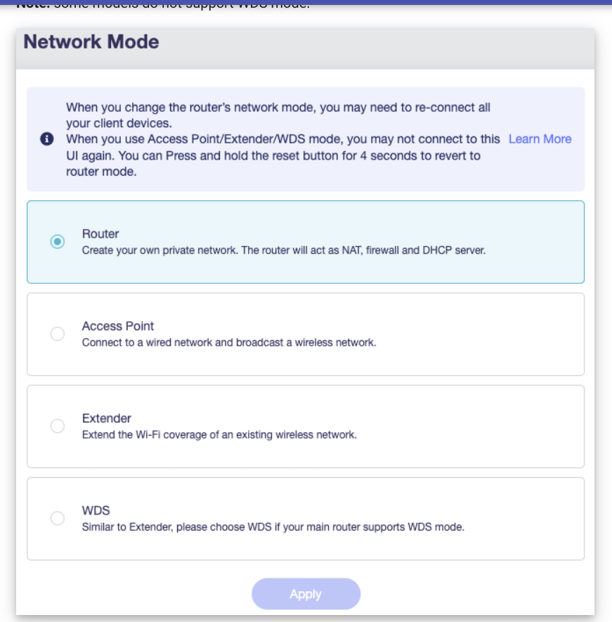

GL.iNet terminology is not “standard”. By default, GL.iNet “Repeater” Internet access method is that it is a router with the WWAN wifi connected to an Internet connection, not the same as an extender that retransmits an existing wifi.
There are other GL.iNet “Network Mode” options:
OpenVPN or WireGuard only works in “Router” network mode, not the other network modes, so you will have double-NAT with both the GL.iNet router and the hotel/friend’s wifi router.
With the “Repeater” Internet access method, you can use different 2.4GHz/5GHz bands at full speed for WWAN/WLAN, or the same band at half speed for both. This is because 2.4GHz and 5GHz each only has 1 radio transceiver that is half-duplex and cannot receive and transmit at the same time, so has to take turns. You can try both configurations and decide what works best for you.

By default, the GL-MT3000 will be in “Router” network mode (with firewall and NAT), which is what you should have, given that you were not aware of changing the network mode (which is not the same as Internet access method), as in the first link I provided:

I initially tried to set this up by changing Network → Network Mode from Router to Extender. This is wrong.
Set the Network Mode to 'Router and use the Internet Tab to configure the wireless access point of the Network you want to connect to.
