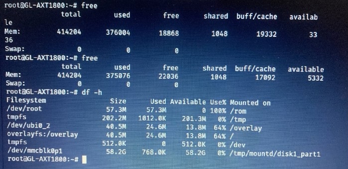

To check if your issue is related to memory or storage, please SSH into your router and run the following command to check the storage usage:
free
df -h

Oh, and to add, as I need the device working, I tried enabling Adguard Home, and enabling large blocklists gave a device full error, presumably using that 40.5 overlay?
(Alas, my Linux partition knowledge isn’t very good!)
I don’t have the time to retry right away; will do soon.
But, to answer the blocklist size, I think it was the blocklists filling up the overlay, and not using the mmcblk0p1, as some of the lists are pretty heavy, like hagezi ultimate at 14MB alone, plus others!
