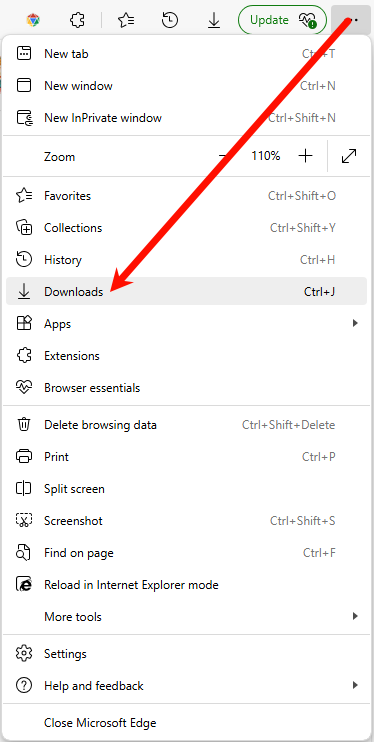

Bruce, thanks for the reply. Two questions: 1. How do I PM you? and 2. I\On the Log page I clicked on Refresh then Export, I got a popup that said "Do you want to download logread.tar?", I clicked yes, where is the exported log?
The download path is related to your browser or you manually choose, please check it
