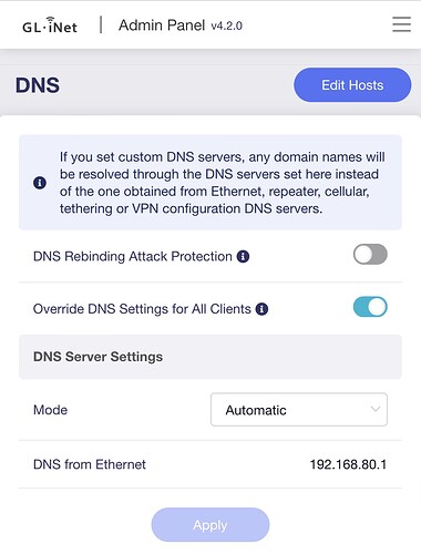

So obviously there is a problem picking up the captive portal. Mine worked at last hotel but not at this one of same hotel chain.
Usually going to IP of hotel router works. But not here. Having read the instructions, found another setting. Now working. This needs to be in the official guide.
Connect the your device to travel router wifi. Turn off vpn. Try pointing browser to hotel/ship router.
Override DNS Settings for All Clients - set to ON.
(Note plug in ethernet and wifi hotel/ship routers have different IP. But both working. Should be able to failover.)
