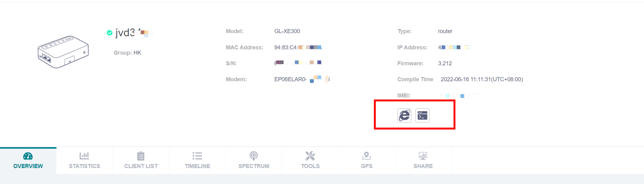

Can we do SSH (like we do with WinSCP) remotely through GoodCloud?
I want to know if I can access internally the router for the route: /etc/rc.button/reset remotely.
If this is possible, any tutorial on how to do that?
Thanks in advance.

Any toturial on how to remove the reset function in the router via SSH?
You can remove or modify /etc/rc.button/reset so that the reset button does not work.
But you can still reset the router using shell command.

Is there any steps to do this through SSH remotely, I mean any commands I can use to do it when you login ssh remotely via Goodcloud?
Do you mean you want to modify /etc/rc.button/reset
In ssh terminal, you can use vi
or nano
. But it is a different story.
vi
is installed by default.
nano
may need to install first. This is eaiser for beginners.
Yes @alzhao i want to do that remotely though Goodcloud SSH.
Can you please clarify what nano is? Is this a command?
Thank you so much for the information @alzhao.
Actually, I found out an easier way to do this without installing nano which is just using the command “rm” and the enter the directory I wanted to romove.
