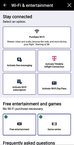

I wanted to take advantage of the inflight tmobile free wifi offer. The prompt for the offer only appears if you access from a mobile device (maybe it’s user agent based?). Do you think they can determine the router isn’t a mobile device after redeeming?

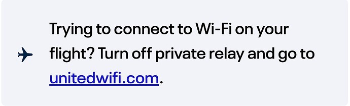

Old thread but really great info. Do you know if there are different airplanes with different wifi capabilities? I'm asking because when I fly, I have no issues with the MT-3000AX on a 777 or 787. However, when I'm on a 737 Max, I get sent
to the info page, then I get a message saying the above. I don't get this message when on the 777 or 787. :thinking:

What device do you use for connecting to the Wi-Fi?
Apple? Did you turn off private relay?
Private relay was turned off. I'm using several devices (tried) to include Samsung Galaxy S24 Ultra, IPad, and Samsung Galaxy S22 Ultra. It worked on some planes, but others it does not. :pensive:
Have you already authenticated on the unitedwifi?
What if you click unitedwifi.com, do you get their portal page?
I do not get their portal page. I am sent to a page that gives the message that I posted above. If you have anything I can try, let me know. I'll be boarding a 737 in about an hour, so I can try something new. My last resort is to just log on normally (without the Beryl MT-3000AX) and that works fine. As stated, this only seems to be a problem on the 737 airplanes.

I tried it and I still have the same issues on a 737. I'm thinking that United is using a different wifi protocol or access for the 737 (Max). When I try to log in through Beryl, I get a "pricing page". When I log in normal (without Beryl), I'm taken directly to the access page to select how I want to log in (normal).
