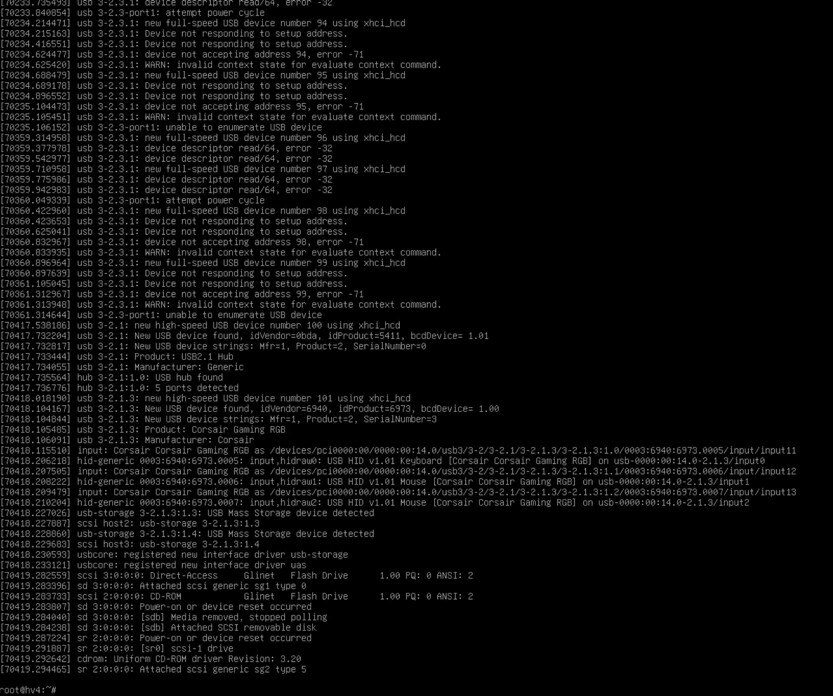

Also, some more information here from screen shot. you can see that a regular keyboard+mouse works. BTW I am using a USB hub for easier debugging unplug/replug. Screenshots & system log attached. Using 1.4.0 beta1.

Oh bummer. I see. So the TinyPilot KVM seems to work fine (based on Pi 4) and is somehow sending the correct signals. maybe I'll show you the screenshot for that in case it helps.
