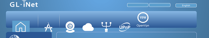

At the first page, the 4g moude is gray color, not the green color like connected to internet.
But the 4g led is on flash, mean on used.
What browser did you use? Is it IE?
chrome 70.
Show this page at 2.271.
Update to 3.006 fireware and back to 2.271.
press shift+F5 to clear browser cache
