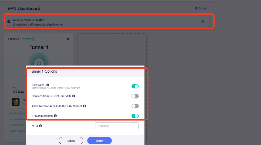

Can confirm having the same issue. The problem was also before on previous firmaware. I was able to fix it with some routing adjustments with ChatGPT, but i don’t remember exactly which one.
I have clean setup of 4.9.0 now (full reset).
This is my settings:
  1. Allow Non-VPN Traffic
I will attach commands output to private message.
