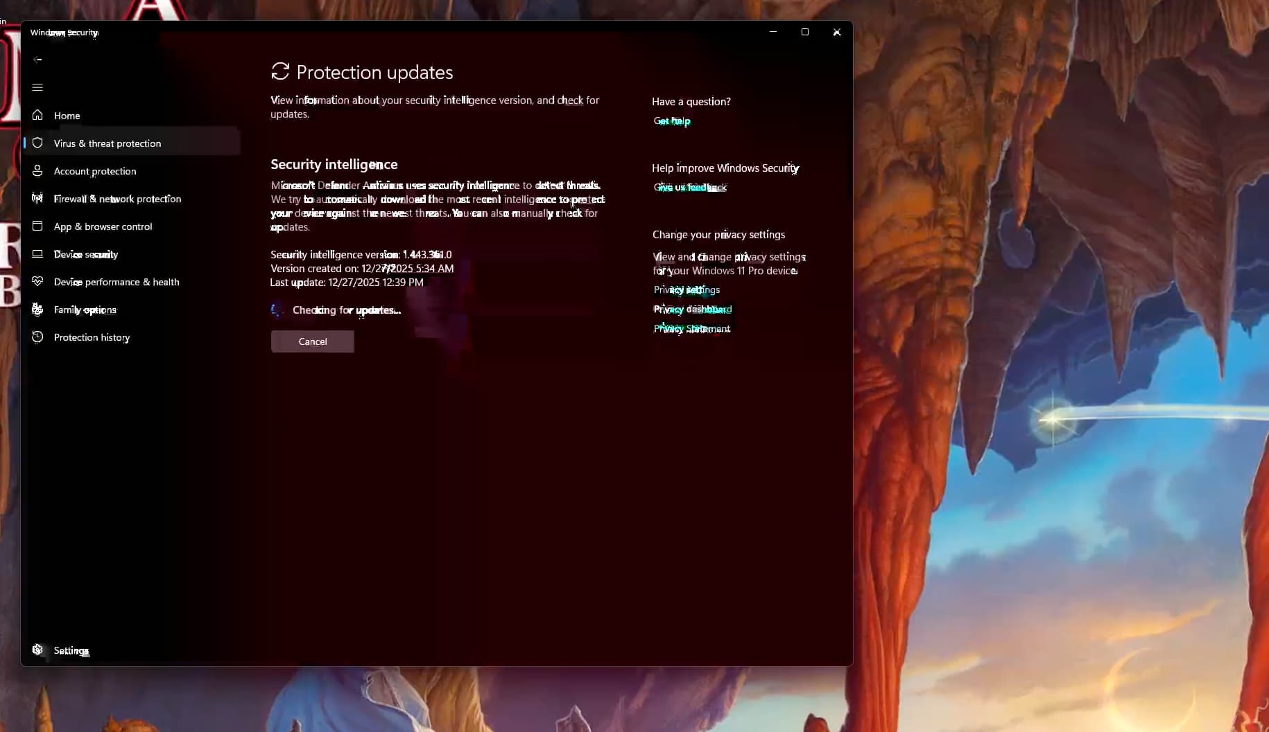

Still occasional glitches…today I had one session where keyboard and mouse were working but no HDMI detection. Had another session where I had good mouse, keyboard, and HDMI but the HDMI image would have pixelation issues. A reboot was needed to fix the issue. Still using WebRTC and normal mode.
Can you provide a screen shot of pixelation?
I will the next time it occurs…it’s quite intermittent.
Here is an example of pixelation…also colors are not correct. This is in full screen mode. sometimes I can get this corrected by going into the windowed mode, then back to full screen.
The other observation I have is every 24-48 hours I have to re-enter my password. When I do this all seems fine EXCEPT when I go to use the KVM I have mouse and keyboard but the KVM does not see any HDMI signal. I have to reboot the KVM and then it seems to work fine again…until I have to re-enter my password…then I know I’ll have to reboot again.
