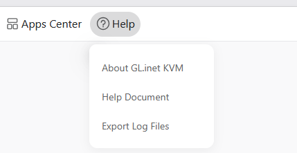

please send me the debug log [email protected]
I sent the log files by email as requested
