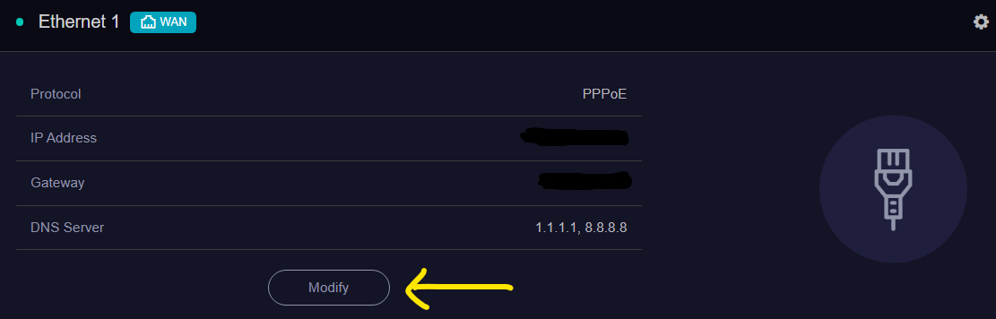

Unless you have a complex or non-standard ISP setup, you can normally enter additional info under each protocol:
In the Internet Setup (press Modify option if you’ve already set it up to edit the configuration):

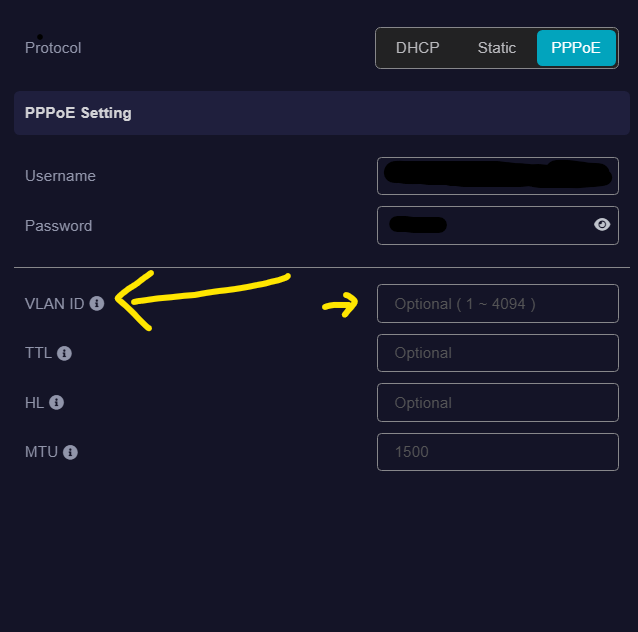

Then select your Protocol, (DHCP, Static or PPPoE), then enter the VLAN ID in the box as shown:
