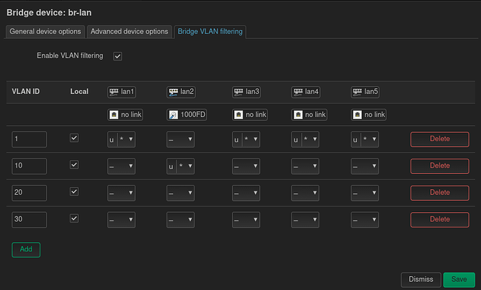

This is my bridge filtering on the main bridge br-lan:
VLAN 10 is designated as the “server” VLAN, while for example VLAN 20 is for the IoT devices.

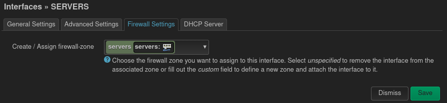

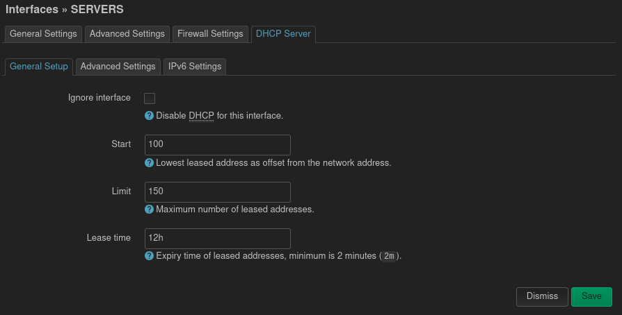

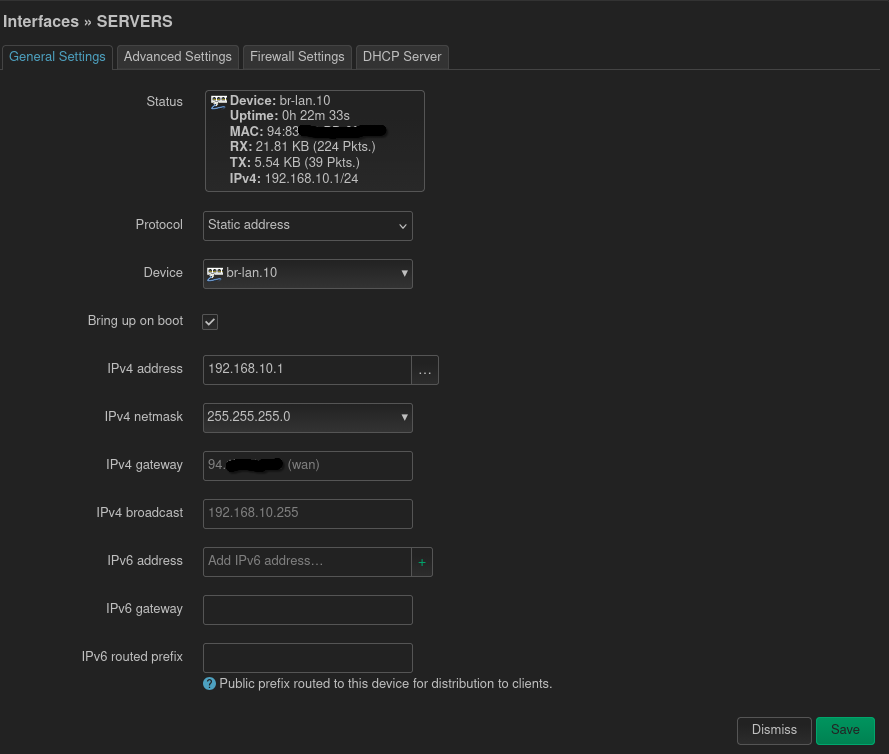

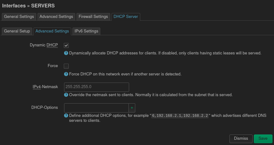

I created an interface for the VLANs and there are the settings for the server VLAN 10:
So to me it all looks fine. And the VLAN 20 which is configured in the same manner works without issues, I added proper firewall rules and specific traffic rules etc.
But for some reason when I plug the server laptop into the port 2 on my Flint2 it gets IP 192.168.0.220. The strange thing is that it does not match any DHCP server on the router. The default VLAN (and the default network on Flint 2 before I even added VLANs) is of course 192.168.8.x. All other VLANs have the 3 octet matching the VLAN ID.
I have no idea why it gets IP like that. It even kinda looks like it gets the IP from the ISP modem, not from the router? It is also currently connected to the WiFi and therefore the main VLAN - on the wifi connection it gets its IP in the 192.168.8.x and I’m able to SSH to this laptop thanks to wifi.
Could you please help me debug this issue and fix it?
There are a few issues here, I'm curious looking to your vlan stanza and it is a wonder vlan 20 is working for you :slight_smile: , or was it on wifi?
Usually: if you want the pvid set, you choose untagged and after the port the vlan cease to exist.
Only one port can only have one untagged vlan, of course it is possible to be more but the pvid deals with that the others become more as a reservation but are ignored, tagged however means you combine a vlan with others or you pass it through.
I expected either a untag or tagged vlan :slight_smile:

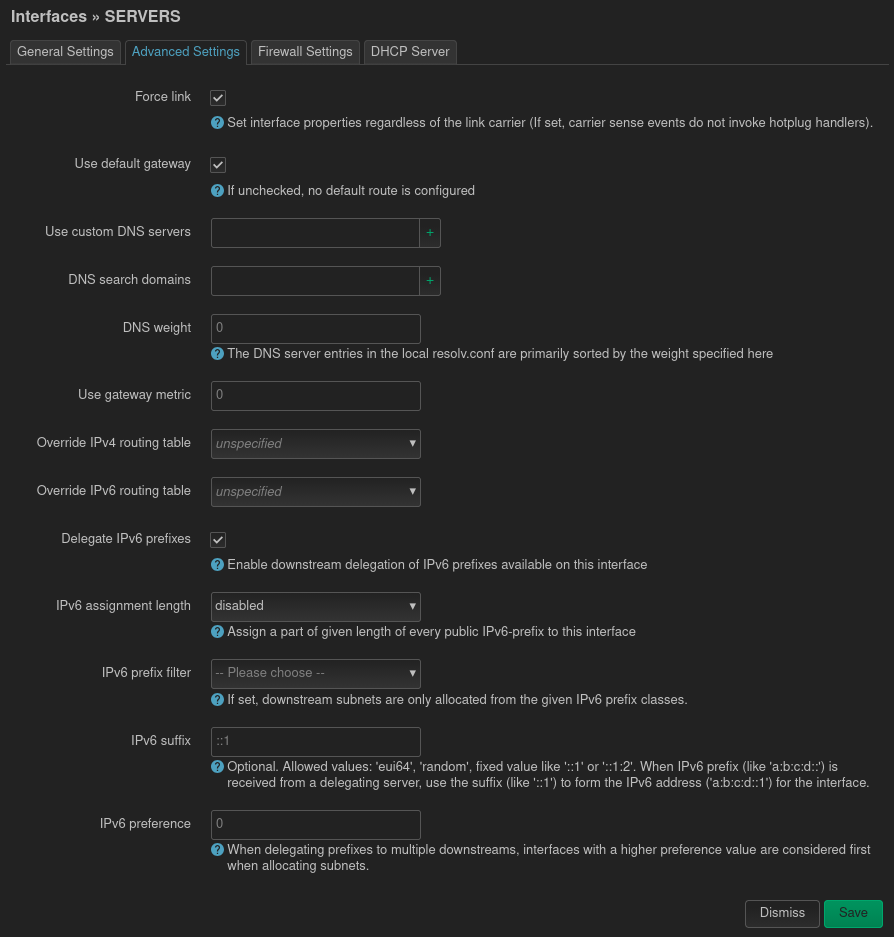

There is also another issue here, I see on each interface you create inside the advanced settings that you check default gateway.
Please uncheck this, because in OpenWrt terms this mean should the interface be treated as a wan like interface or not, in this case you don't want that, because it is possible a default route is being set to this interface rather than wan/wwan, this could theoretically explain why you see a different network.

I set PVIDs like that while trying to fix the issue. Originally I didn't have any pvids and it was behaving in the same manner.
But to be honest I didn't fully understood your comment. You are saying that this configuration of PVIDs or untagged ports is wrong? Could you try rephrasing it? How would I set it?
The default gateway was set like that by default. I tried deselecting it now but it seems it did nothing.

I have adguard home enabled. But I'm not sure if it could have any impact.

Strange, and you still see this ip appear on the flint lan port 2?
Its the flint 2 who gets the ip or the client?
Can you try and type that address in browser and see if it shows a web page or a common device?
Config seem ok.
Flint is accessible on normal ip 192.168.8.1. It is the laptop (my pseudo server) which gets wrong IP. Currently this laptop is connected both via wifi and ethernet cable.
From wifi it gets the IP 192.168.8.10, which I'm using to connect to it at the moment.
From cable connected to LAN2 it gets IP 192.168.0.220, and I'm unable to connect to that IP.
I'm thinking here, could it be you have set a static ip on one of the interfaces on the laptop?, maybe for u-boot and then been forgotten to turn it off?
I know that if you use ipconfig with a fixed ip you will get confused I have had this a few times.
I installed fresh Debian on this laptop and I didn’t set static IP on it.
I also tried creating separate network without using bridge filtering - I removed port 2 from the br-lan and created separate bridge and interface. It didn’t help. I also tried assigned the lan2 device directly to the interface also without any luck.
I suspect that the modem might be breaking my setup somehow. In bridge mode the ISP modem should have IP 192.168.100.1, but maybe it doesn’t for some reason. I didn’t check that yet.
I plan to go to that laptop and physically experiment a bit once I will have time. Maybe unplug Flint2 form the modem for a moment and check what happens then. Maybe I will also try connecting to the modem and check the optioons, but I doubt I will find anything useful.
you could try another trick :slight_smile:
the interface on lan2, can you go to dhcp settings and check force dhcp?
this option is designed for when you have a concurent dhcp server somewhere in your network trying to override your existing dhcp server.
I don't see the (option vlan_filtering '0').
I know this sounds backwards, but if you're running the non-OP24 version of the GL firmware, then on the br-lan bridge, uncheck the 'Enable Vlan Filtering' box and save and apply to see if that helps.
Reference.
I don’t know why would you want to see (option vlan_filtering '0') since the 0 means it is disabled?
But well, I tried that and my whole network went down and does not want to recover. OpenWrt does not seem to go to the previous setting. I hope I will be able to connect to it somehow via ethernet or something. Otherwise I guess it is game over and I will need to do a factory reset now and redo everything?
