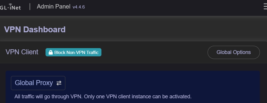

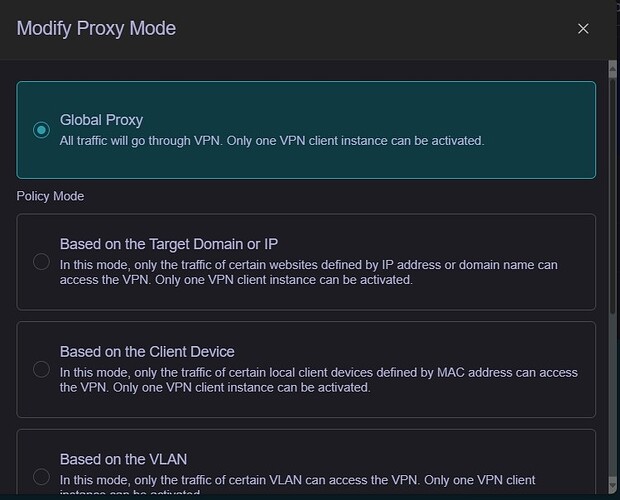

Your Public Internet facing IP should be the same as your WG Client fr your VPN Provider. Check VPN → Dashboard → VPN Client → Proxy Mode (… & Global Options). Confirm/test via IP Leak.

This assumes firmwar 4.4.6-release1, the current stable for the Slate AX/Flint v1. Flint v2 should be near identical. Set according to your needs... ie: VPN Cascading.
Global
WG Client
VPN/WG Server
2023-12-26 17_29_33-GL.iNet Admin Panel - Chromium
I got your PM, obviously. So your WG Client is communicating as it should be (1.89GiB). So it should just be a matter of flipping on the VPN Cascading toggle & making sure other devices have the approp. confs loaded for authenticating to your WG Server. IP Leak should show the same Public Internet IP as your VPN Provider’s IP.
