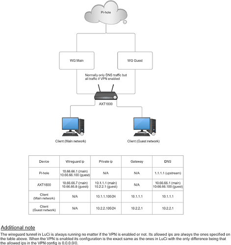

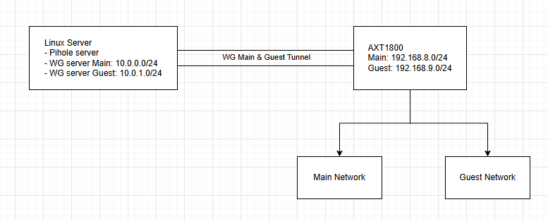

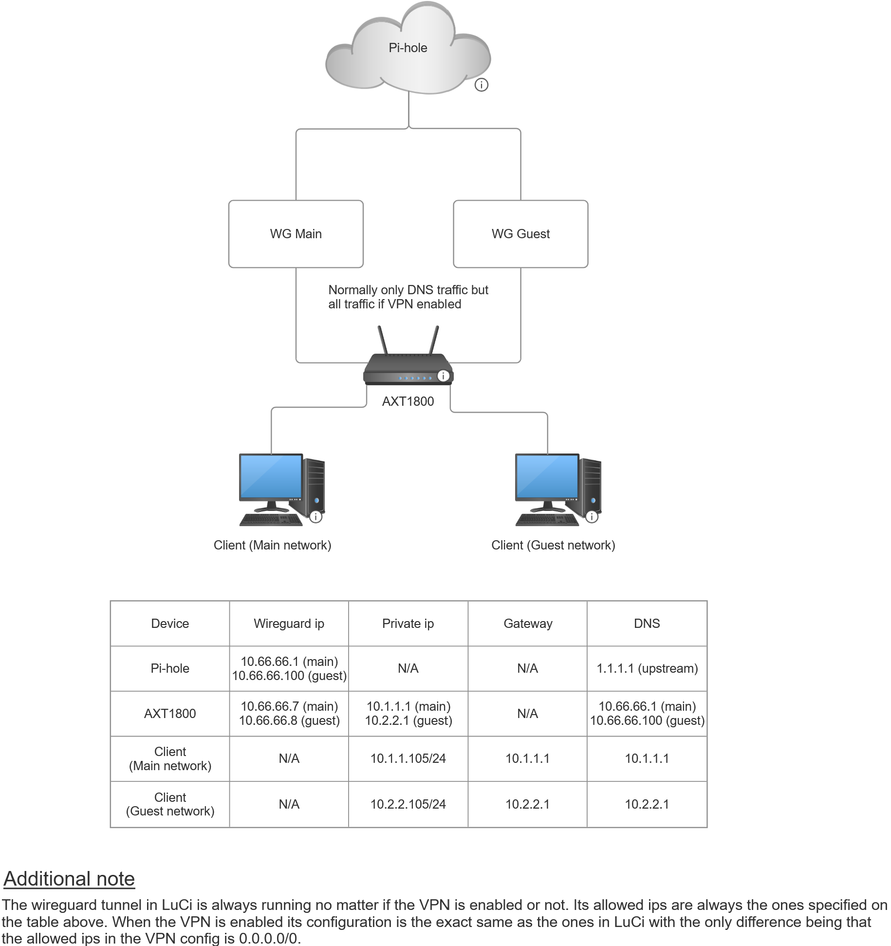

Could you draw a detailed network topology diagram including IP addresses, gateways, DNS, VPN addresses, and other configurations so we can better understand your user case?
Additionally, which firewall rules were removed would make it work in version 4.7.x?
Sorry for my late reply but here’s my best effort at creating a network topology diagram.
I don’t remember exactly, the only detail I can recall is that they were 2 rules named “unnamed_rule“ and they included Adguard’s port of 3053.

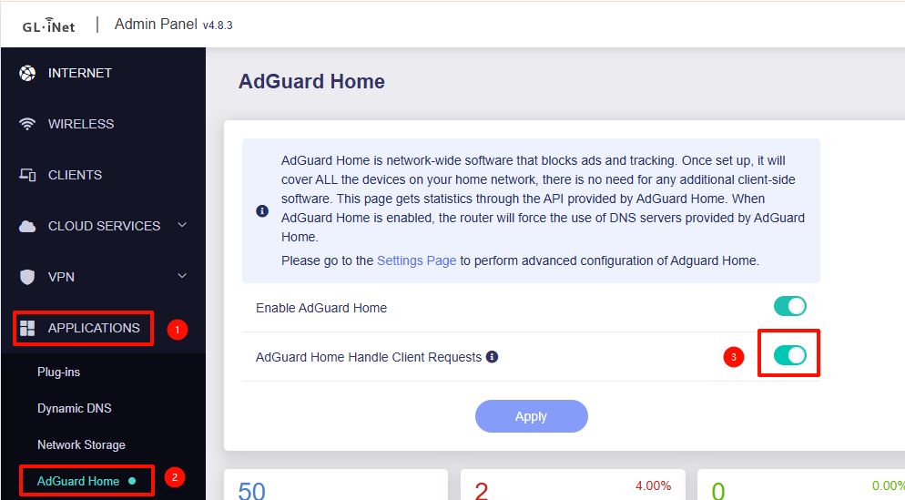

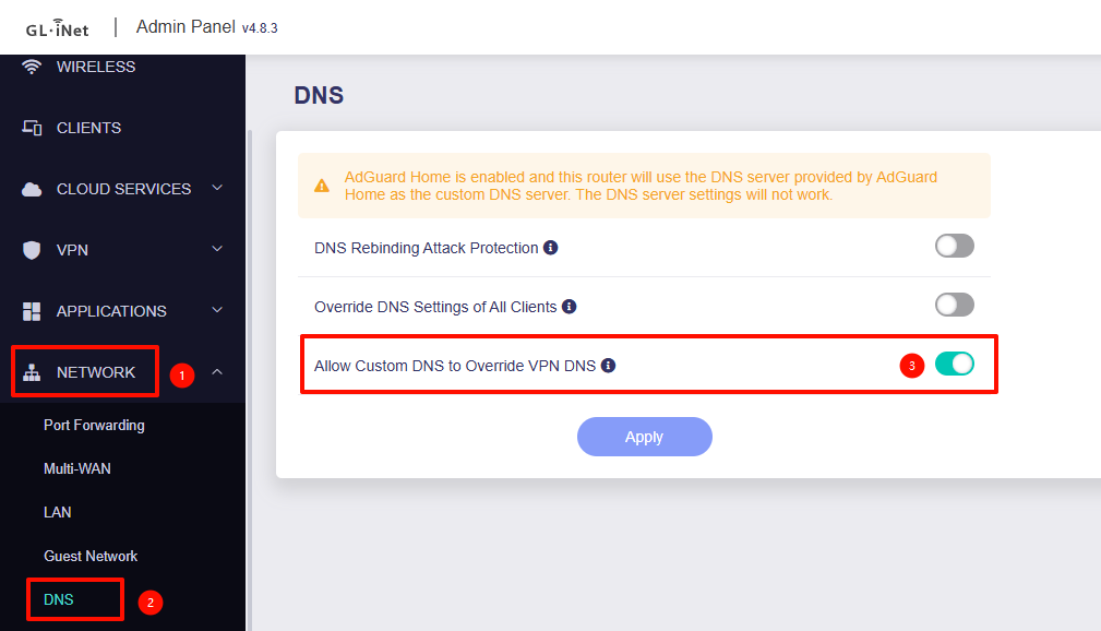

Please try disabling "AdGuard Home Handle Client Requests" and "Allow Custom DNS to Override VPN DNS".
This should allow the LAN client to use the VPN DNS directly.
But in this case, it seems unnecessary to enable ADG Home? :thinking:
After disabling "Allow Custom DNS to Override VPN DNS" the only way I got it to work was disabling Adguard completely, only turning off its client DNS handling didn’t change anything in my case. Even then it only worked sometimes, it connects to Youtube but not Amazon or my university’s webpage.

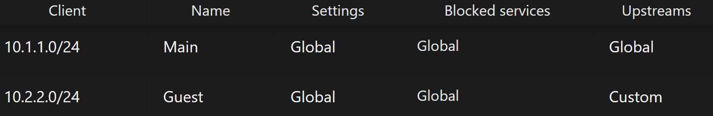

Yes, you are right! I don’t even use it for ad blocking as the Pi-Hole does that, the only reason why I’m using it is so I can have clients on the main and guest networks use a separate DNS. So, pointing main network clients DNS to 10.66.66.1 and guest clients DNS to 10.66.66.100. If there is a way of doing this without Adguard, I believe this might be a better solution in this case rather than messing with Adguard.

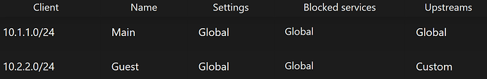

As you can see here the guest subnet has a custom upstream which is 10.66.66.100, I don’t use Adguard for anything more than just this.

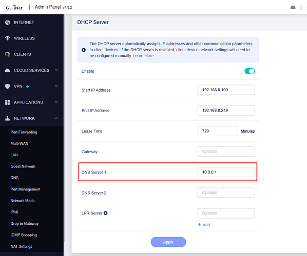

Of course, the simplest method may be to let DHCP automatically distribute the DNS settings to clients.
Please refer to LAN - GL.iNet Router Docs 4 and Guest Network - GL.iNet Router Docs 4 .

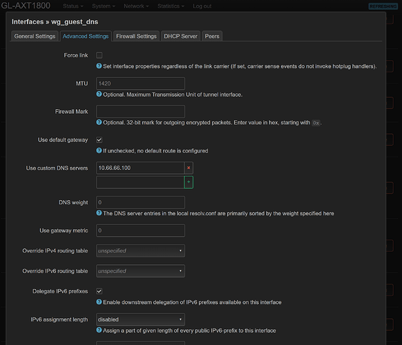

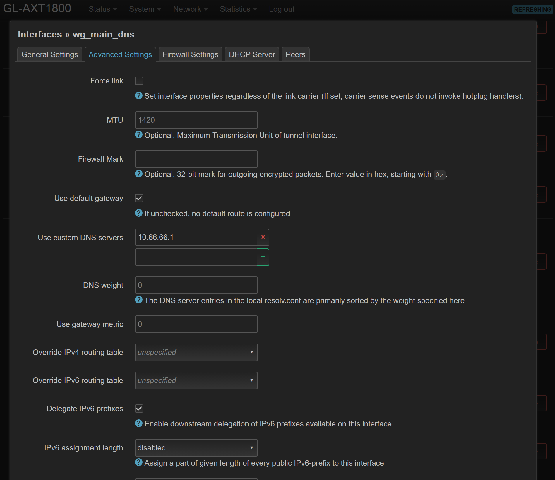

Yes, I have it set for both.
Here is the one for main:

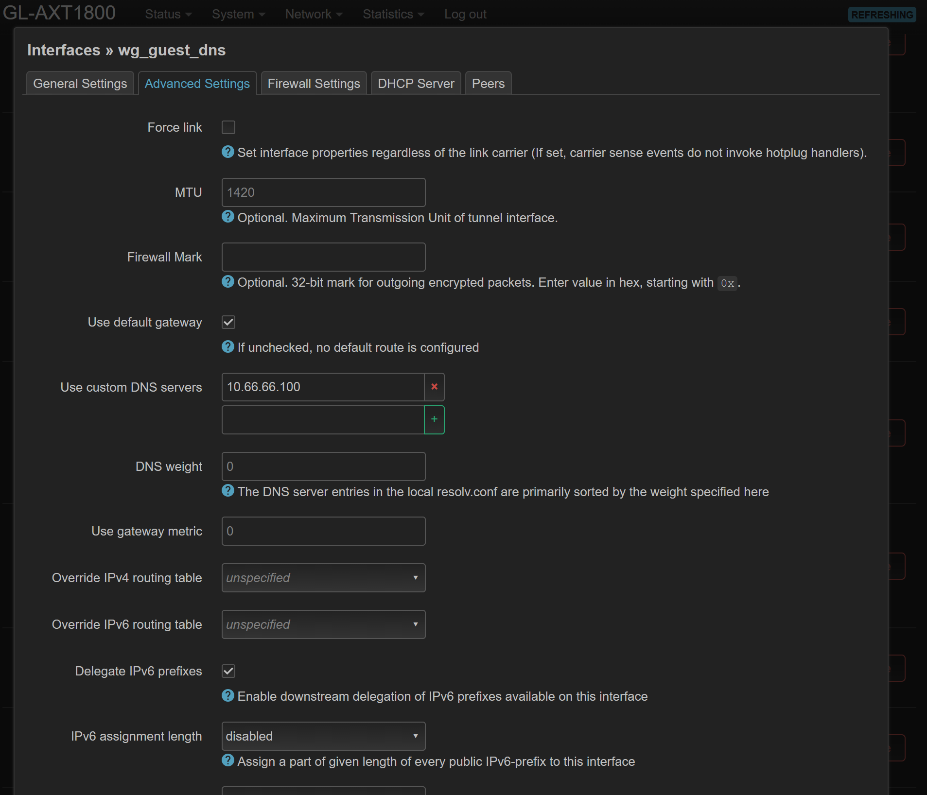

Here is the one for guest:
Yes that’s true, but I’d like to have a separate wireguard tunnel as shown in the diagram so I can better keep track of both networks and their statistics on my Pi-Hole interface.
I set the DNS server 1 of my guest network to 10.66.66.100, however in my Pi-Hole interface I can see that traffic is going through the main tunnel. Also if I turn off “Override DNS Settings of All Clients“ the client on the guest network cannot access the internet.

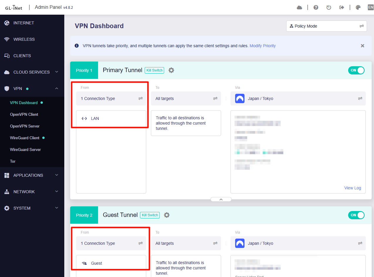

If you’re configuring WireGuard via LuCI, proper traffic separation between your main and guest networks requires installing and configuring luci-app-pbr.

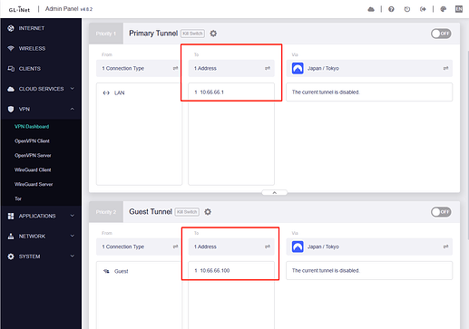

As a simpler alternative, the GL.iNet UI’s Policy VPN feature natively supports traffic splitting and DNS handling without additional setup.
Policy VPN:
DNS:
Please refer: VPN Dashboard - GL.iNet Router Docs 4

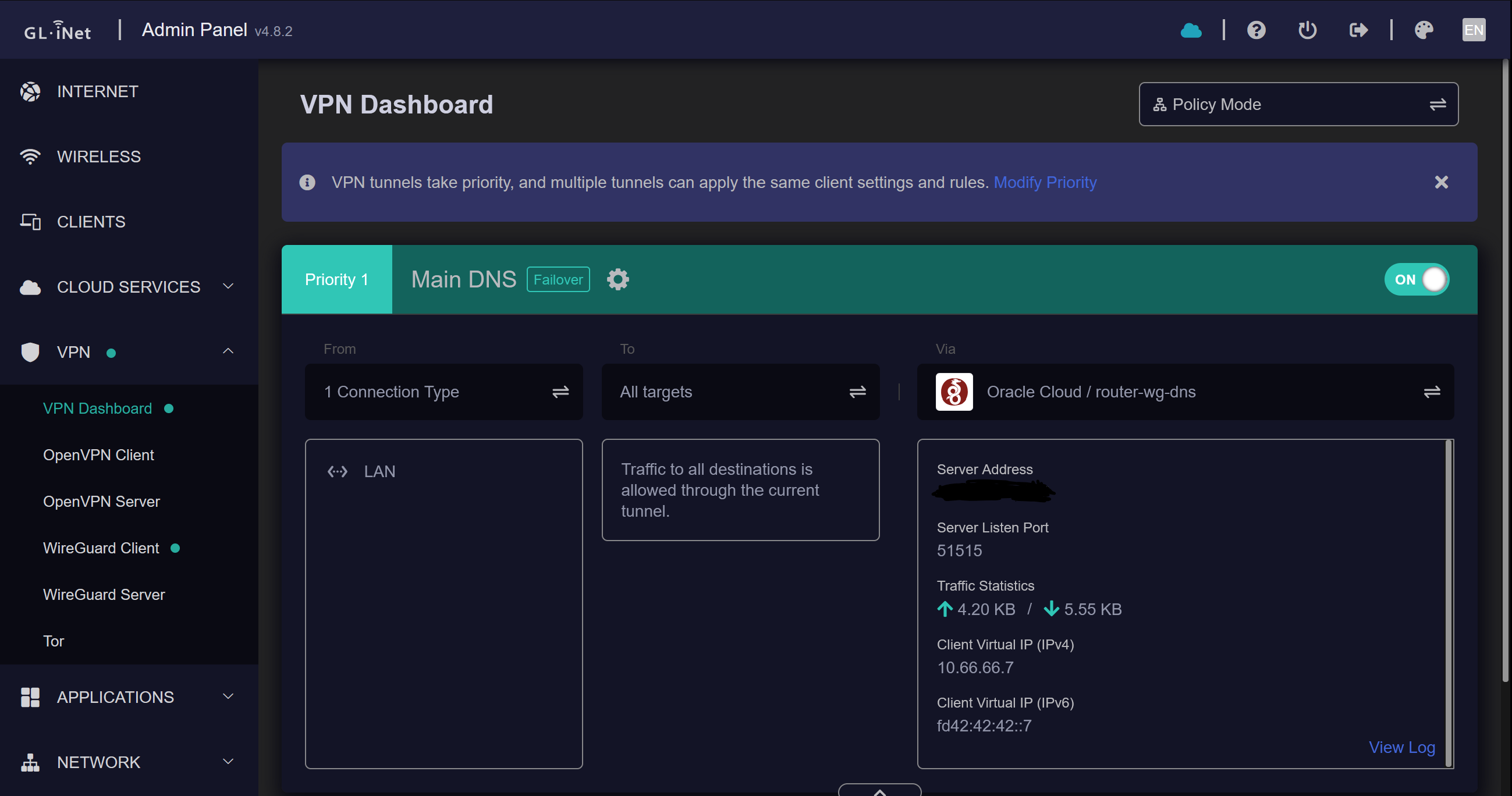

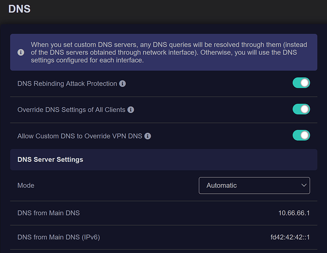

I have tried this however it has failed to work. The configuration I used when testing is as follows:
Adguard and all the wireguard configs in LuCi were disabled. DNS was set to automatic and all 3 options in the DNS menu enabled.

With this I get no internet connection on connected clients but DNS is detected correctly in the DNS menu. I also tried changing the targets to:
  1. 10.66.66.1
  2. fd42:42:42::1
Which didn’t work. I also tried setting it to the endpoint ip address but that also didn’t work.
Note: The wireguard configuration works completely fine with allowed ips set to 0.0.0.0/0 and ::0

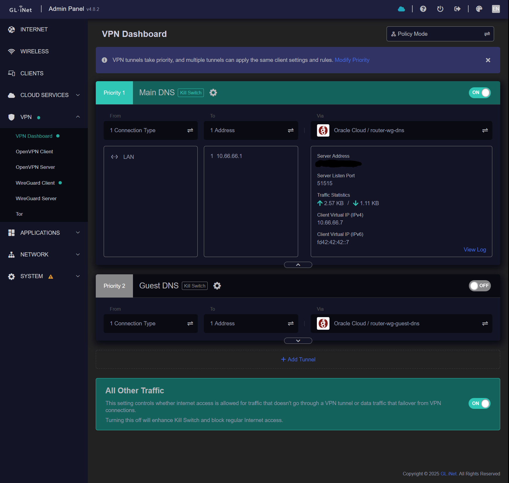

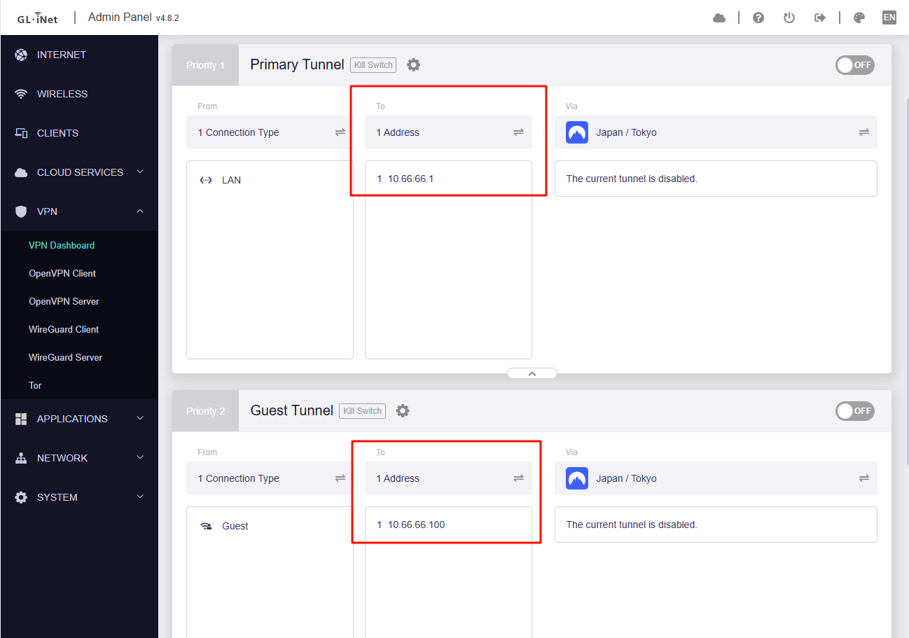

Do you mean you want only DNS traffic to be transmitted through the VPN tunnel?
Please try adding the DNS address in the “To” field.

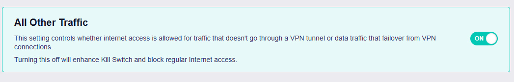

And make sure the "All Other Traffic" is ON for other traffic being transmitted over the WAN.

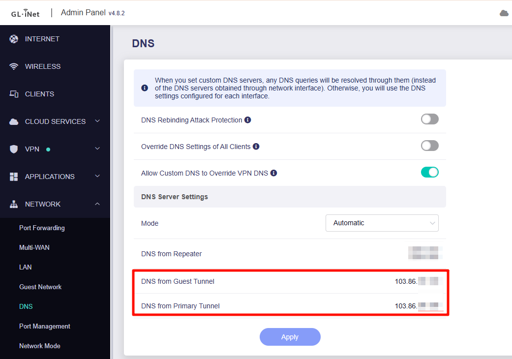

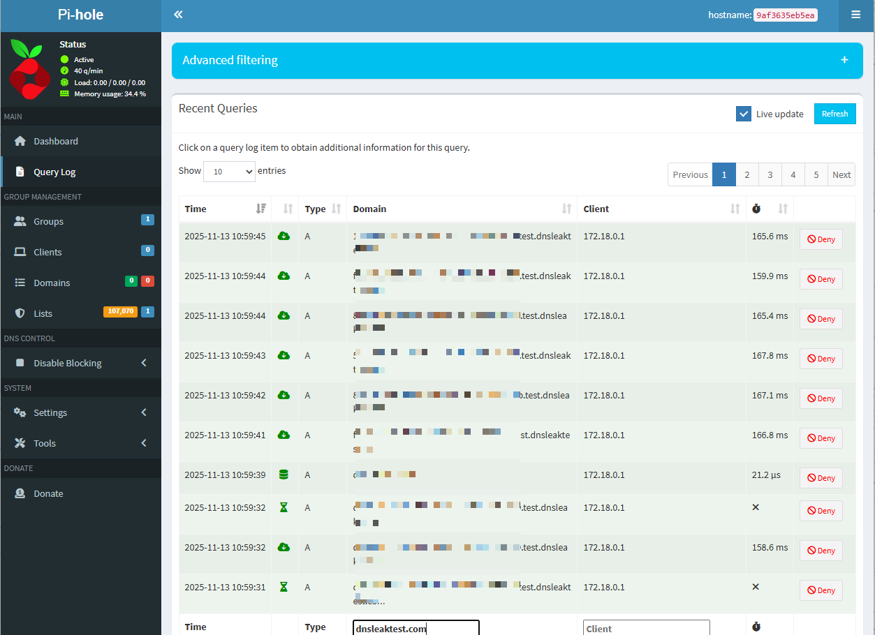

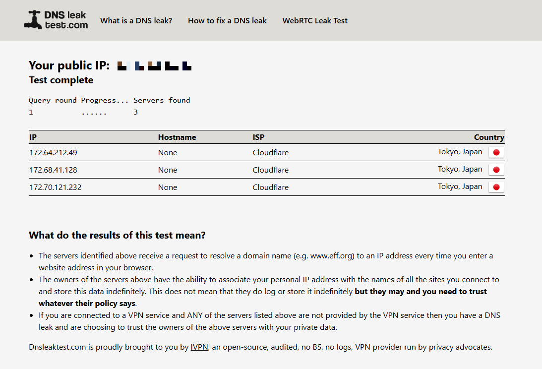

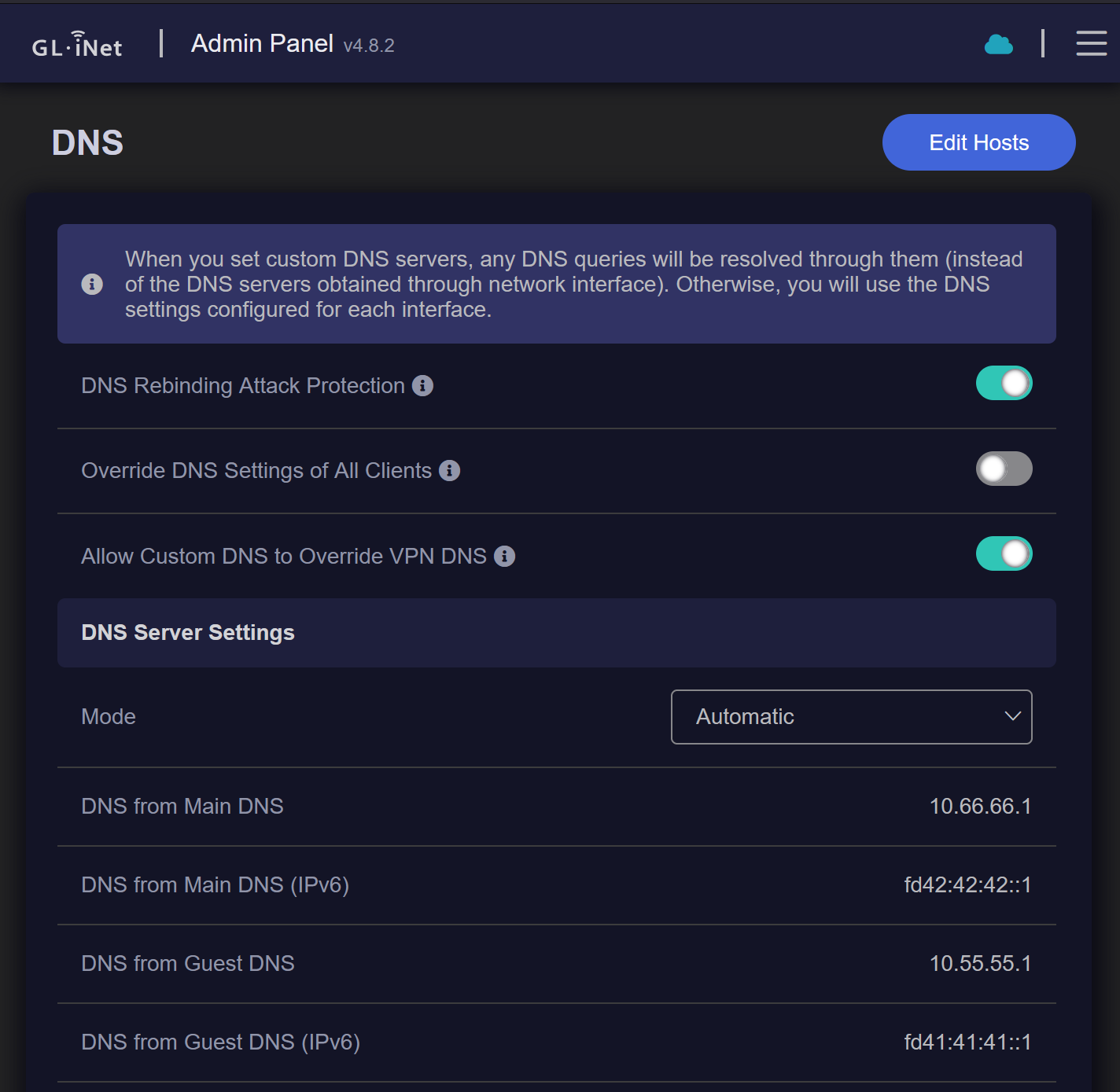

After following the steps you provided I get an internet connection however DNS leak test websites show my isp’s DNS instead of my Pi-Hole and I get no traffic in Pi-Hole.
(Adguard and the wireguard interfaces I added in LuCi disabled again)

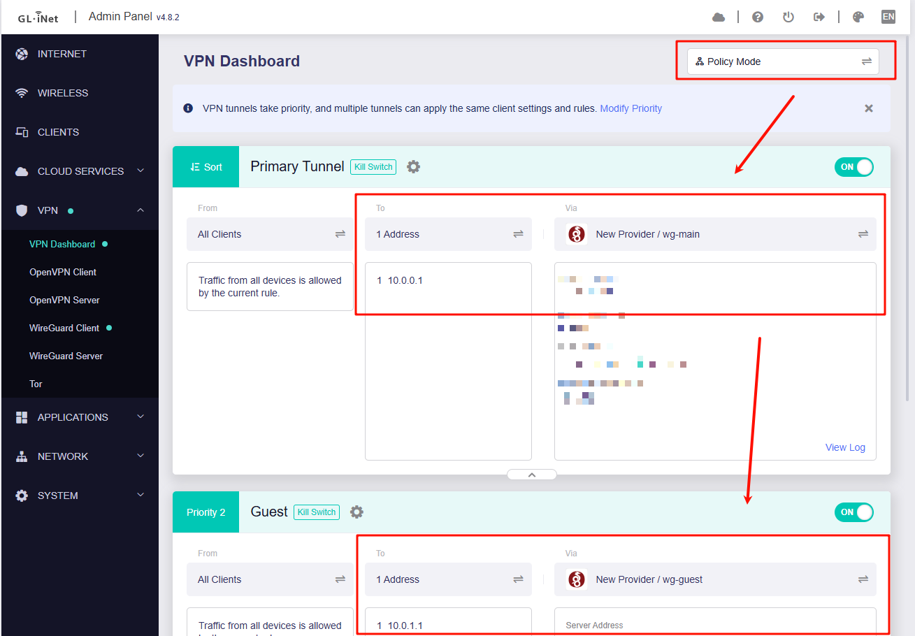

VPN configuration:
DNS settings:
This behaviour is quite unexpected for me as the DNS page clearly shows the correct DNS and the wireguard configuration used seems to work correctly. I also tried setting the DNS to just 10.66.66.1 which made no difference. Is there something I’m missing about the repeater settings or something similar?

We also noticed that your WG Main and WG Guest interfaces share the same subnet. This may cause routing conflicts and prevent proper functionality.
Below is the verified configuration we tested locally after applying improvements.
Network Topology:

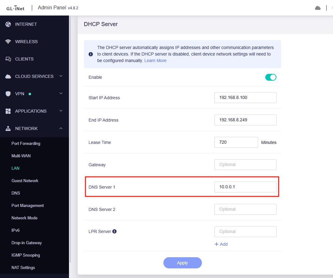

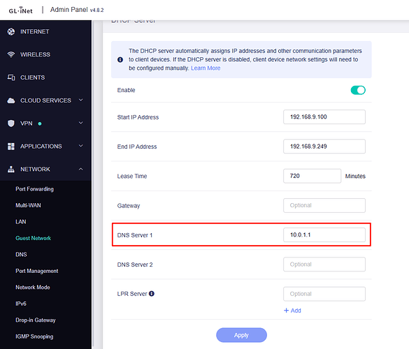

  1. Assign DNS addresses via DHCP for each network:
    For Main:
    For Guest:
  2. Enable VPN Policy Mode and allow only the specified DNS addresses:

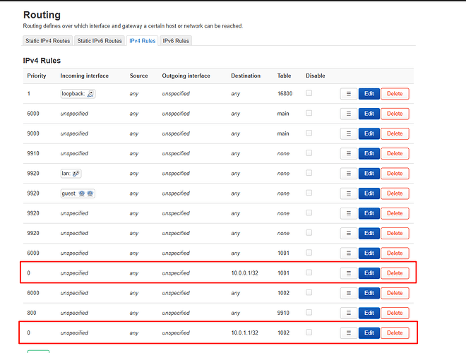

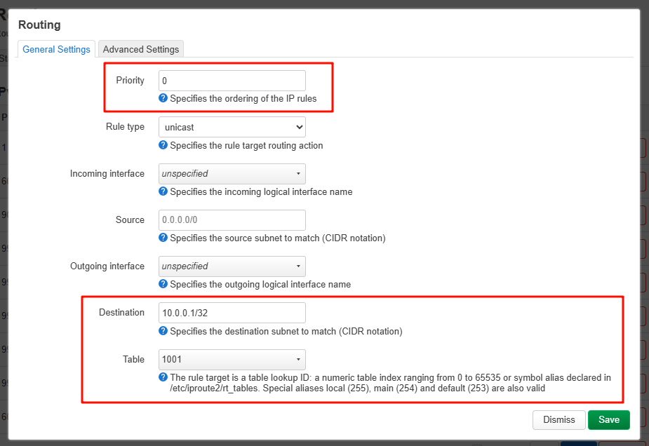

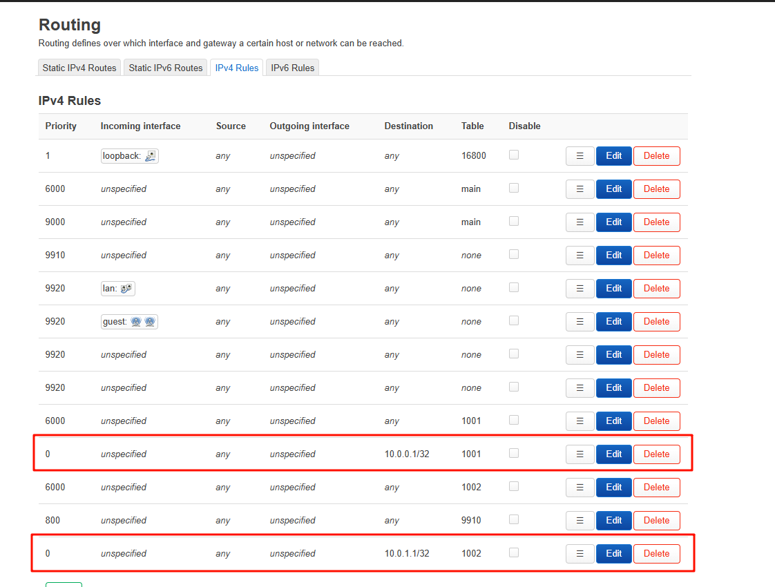

  3. Add the following rules under LuCI → Network → Routing → IPv4 Rules:
Note: WG Client 1 should use table 1001, WG Client 2 should use 1002, and so on.
Example details:
Verification:
This is the solution! After following the steps exactly and making sure to have the exact same order in the routing page as the given image, it works perfectly! Thank you very much for all the help and time you spent on this matter :slight_smile:

Edit 2: The issue seems like it is caused by the “Override DNS Settings of All Clients“ setting. After disabling it there appear to be no leaks.
DNS settings:
