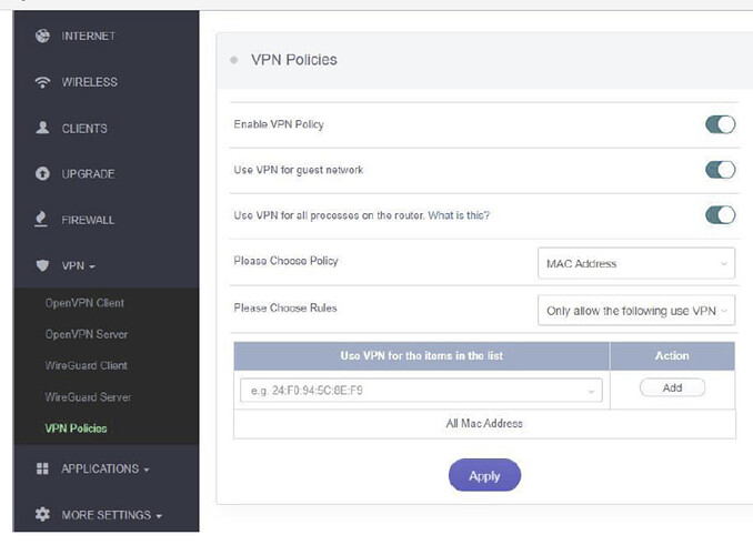

Similarly, the owner's manual displays this VPN Policy view:
[image]
In place of VPN Policies on the left panel, it now shows Tor, just as in your screen shot.

Through the screenshot you posted, it looks like v3.x firmware.
Please confirm the current firmware version on the "UPGRADE" page or "SYSTEM -> Upgrade"
Please upgrade the firmware to v4.7.2 if currently is v3.x, and try to connect the VPN one more time.
https://dl.gl-inet.com/router/sft1200/beta
The reason it looked like v3.x is because it was from the owner manual. It shows the desired VPN Policy option which was no longer present on v4.3.24. For some reason that screenshot was not allowed. v4.3.24 showed the same options as in the screenshot that you sent.
