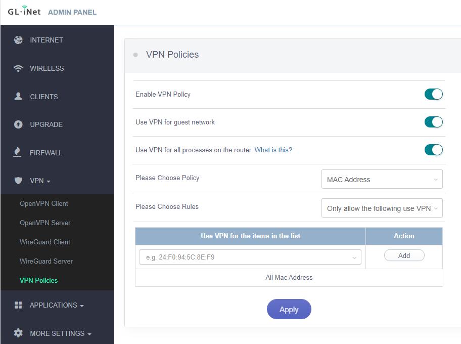

Thats the old admin panel with the mentioned options.
Thats the new one where u can only pick one option.
Yes, current firmware can only have one of the three policy modes.
Combined Policy mode will be redesigned in firmware 4.6 or 4.7.
