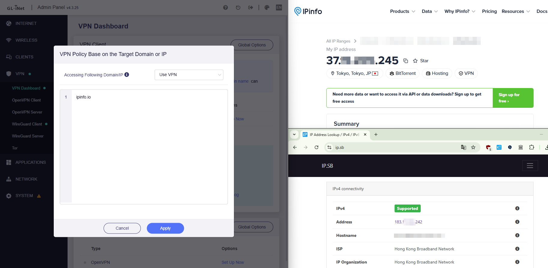

We tested locally with the SFT1200 running v4.3.25, but were unable to reproduce the issue.
The domains in the list are correctly routed through the VPN tunnel.
In Policy Mode, the VPN requires client devices to use the router’s LAN IP as their DNS server in order to properly apply domain-based routing.
Therefore, please make sure that encrypted DNS is disabled on your client devices/browser, and that they are configured (or obtain via DHCP) to use the router’s LAN IP as their DNS server.
