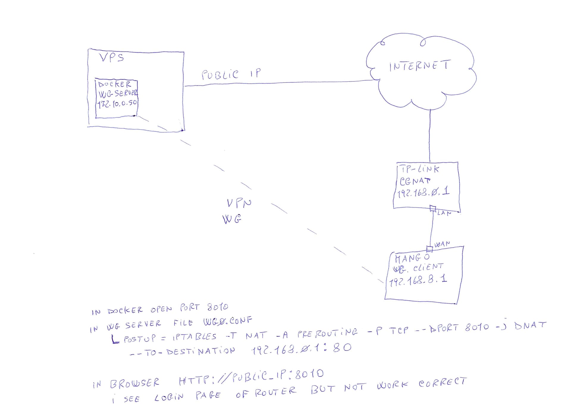

Hi to everybody, i need help about routing on GL-MT300N-V2.
I have Mango (IP 192.168.8.1) with IP cam wifi, this router are connected with Tp-link (LTE) (IP 192.168.0.1) with wan port. The provider LTE are in CGNAT so not reachable from Internet. I have a remote VPS where I have installed wireguard Server on Docker. I use Mango to connect with the server in VPN and it work and my CAM are reachable from Internet.
On my VPS with wireguard server I have routing the port 8008 to my Mango in port 80, and this work perfect.
PostUp = iptables -t nat -A PREROUTING -p tcp --dport 8008 -j DNAT --to-destination 192.168.8.1:80
I do the same thing to reach my Tp-link
PostUp = iptables -t nat -A PREROUTING -p tcp --dport 8010 -j DNAT --to-destination 192.168.0.1:80
But Mango block the connection to my tp-link.
I'll show my peers configuration:

the destination 192.168.0.0/24 is unreacable because are in double nat?
What I can do to bypass?
I think about wgclient need to routing to WAN, but I do not know how....

Let me confirm the topology as follows. You want to access the tp-link router directly through VPS, right?
I did almost the same thing as you, but it was very smooth and I had easy access to my parent router.
wg server configure on vps
wg client configure on router
The only thing I did was set the following firewall rules on the router
iptables -I FORWARD -j ACCEPT
you are right.
I can reach the router, but I see imperfect page, like the image attached.
analyzing the page i see the path of the "link" are ../CSS ecc...
So I think the page not load correct.
It looks like you've succeeded, but the page you're trying to visit isn't fully loaded because it relies on sites like www.w3.org. You can try tracing the path to www.w3.org
