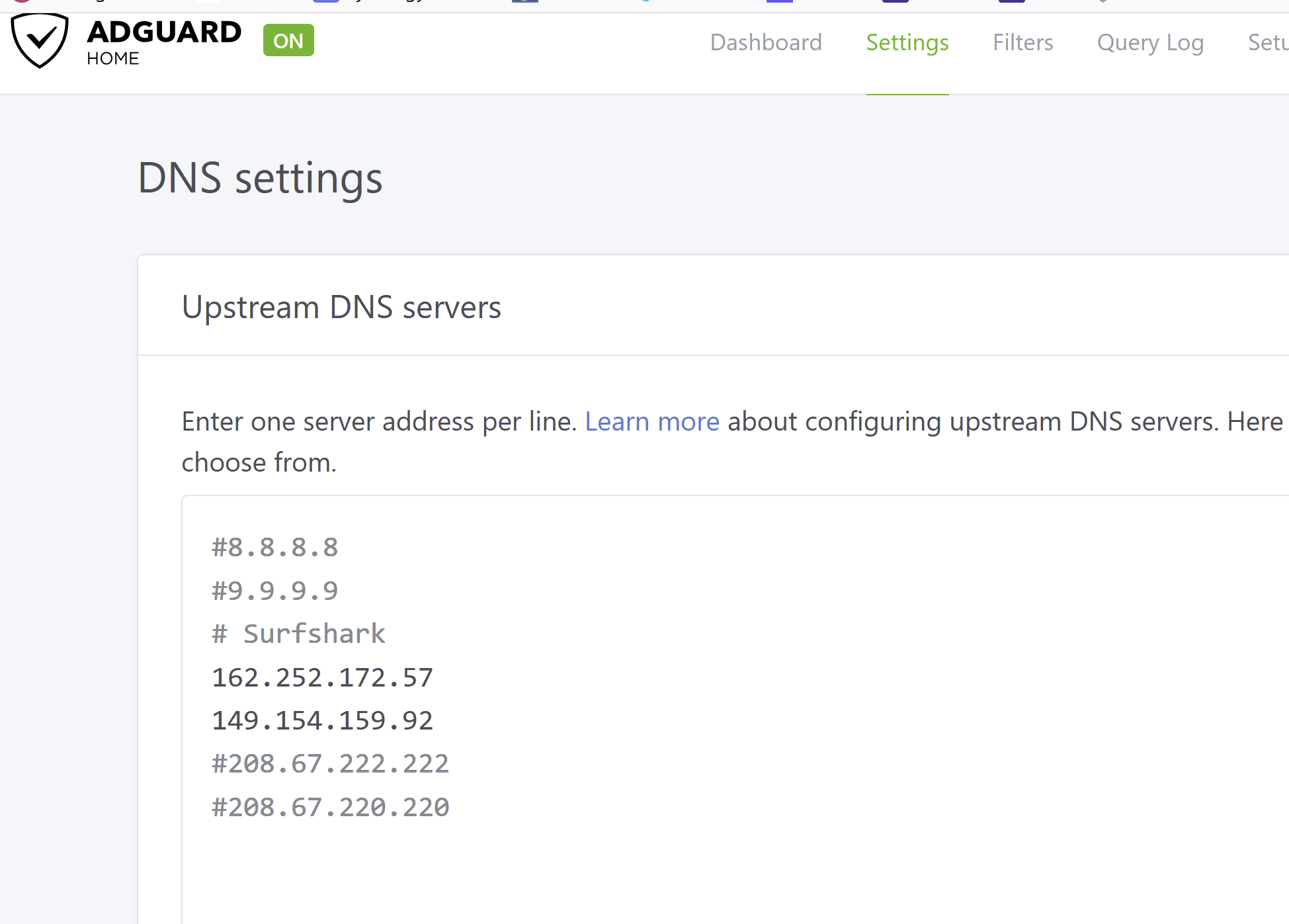

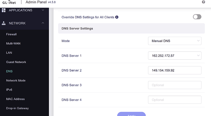

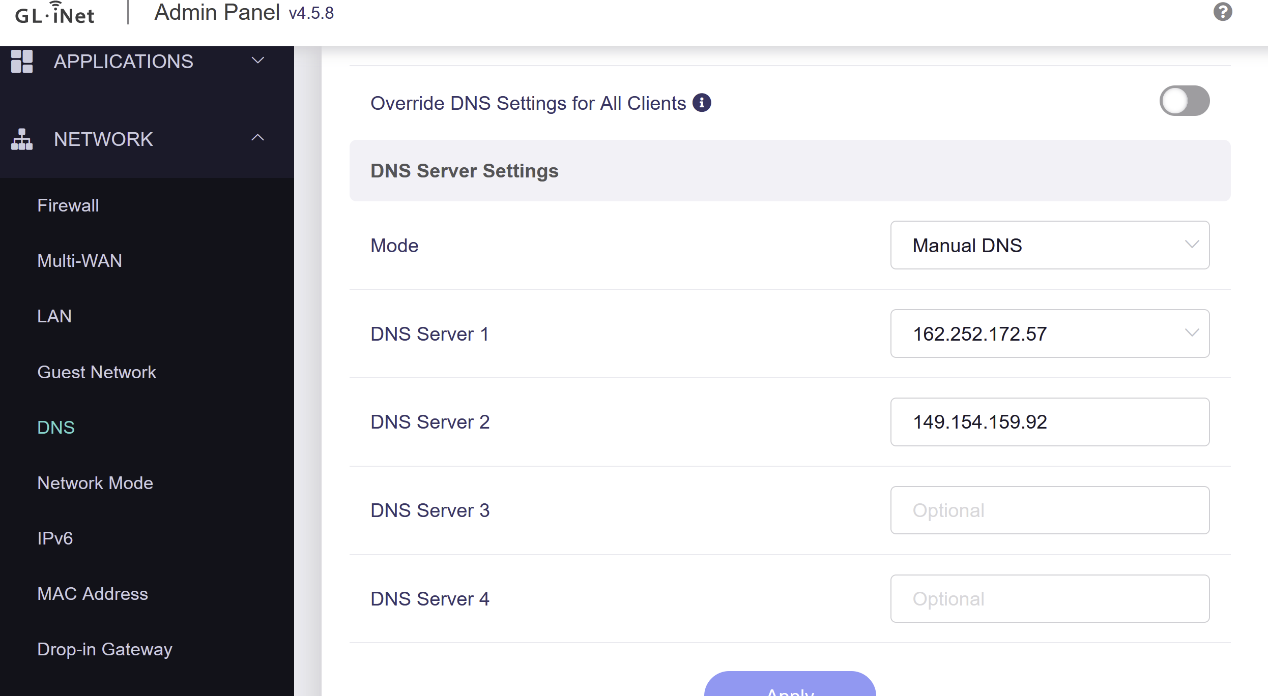

So... I have the DNS servers set to Surfshark addresses in the manual DNS server page in the Network section, I use Adguard home and have the Surfshark DNS servers set there. Also, the config file for the Wireguard client uses the same addresses.

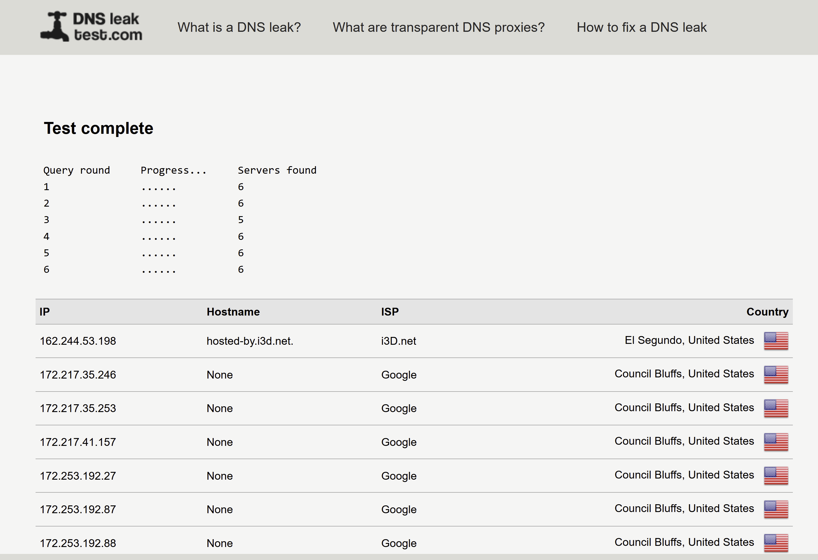

Just for fun, I disabled the VPN and reset the DNS servers in Adguard Home to their default. I went to 'dnsleaktest.com'. Here is a partial screen shot of the results:
I then re-enabled the VPN and ran the test again. I got the same results with or without the DNS server changes in Adguard Home. This indicates that the DNS settings in Adguard Home are being overwritten
