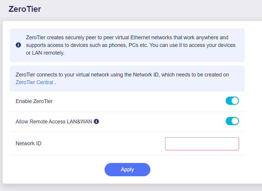

Pls note, Zerotier will be added to the default UI in firmware 4.2.0
Thanks for this input @alzhao, any idea if and when 4.2 will be made available for the MT1300 ?
should be soon as I just get 4.2 for AXT1800 minutes ago.
Some images for your reference.
