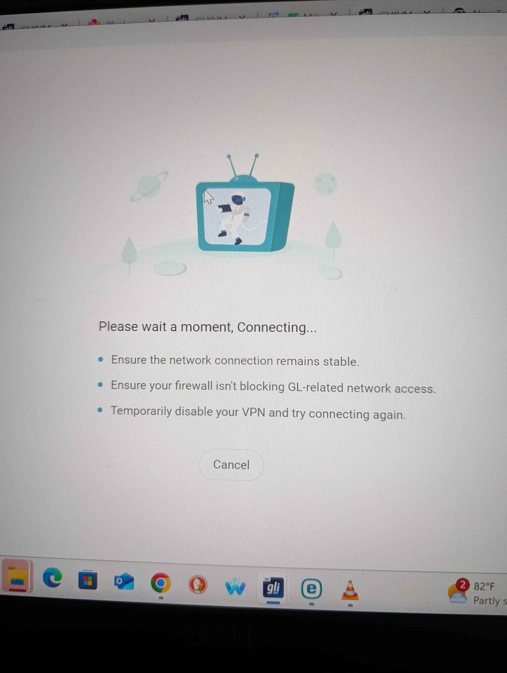

Web browser can reach remote GLKVM but app not
Web browser can reach remote GLKVM but app not. When I open GLKVM app its saying connecting then gray screen and nothing. But when I try from web browser I can reach GLKVM connected remote desktop.

When unable to connect, what percentage of the connection process is complete?
I'm on Windows 11, Percentage varies typically between 52-79.

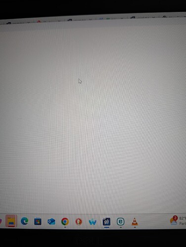

Got it, tried it out. It now goes to 100%. But all I get is a blank window.
glkvm_app_log-1.2.0.r1.zip (2.4 KB)

Hi - did anything come of this? I tried connecting via the app and its bailing out at up to 75% but a web browser allows me to connect fully.

I am having the same issue on my end also I have no problem viewing my KVM via web browser but the app shows Gray screen. The Only way the app work is if I am connected to same network. I have no problem accessing computer via browser via tailscale or Cloud
May I know which product you are using and its firmware version and could you please provide us with the app log.
My current device is the Comet PoE Firmware Version is 1.5.1
glkvm_app_log.zip (20.5 KB)
