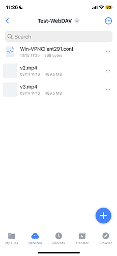

2 users ( read and write ) and two independed partisions on ( /dev/sda2 ; ext4 )
Glinet app on the iphone could do everything with files and folders
Nplayer on iOS successfully logged in but only read ( movies ) and couldn’t go inside subfolders
What i’m doing wrong ?

This issue probably is related to the NPlayer APP.
Since the subfolders in others APP with WebDav are available.

Hi Bruce,
So, at the moment i've figured out:
Problems with: Finder (MacOS), Mountain Duck (Connected, but dropped file transfer; MacOS)
Without problems: Transmit 5 (Panic.com ), Fileball (iOS), FE File Explorer (iOS)
Keep searching, learning, ... -)

Thanks, this may be caused by incompatibility issue with some APPs, also many thanks for the APP testing.
Is it possible to find out the difference version of the WebDav protocol which the APPs of with issue and without issue?
