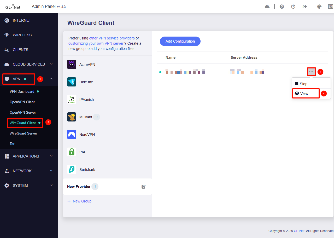

Question: I am not currently geographically near my server nor will I be for the next month. I had not set up GoodCloud ahead of time, which I now regret. Is there anyway that I can access the server logs from afar, or do I need to wait until I am physically there / have someone in the home where the server is located get them for me?

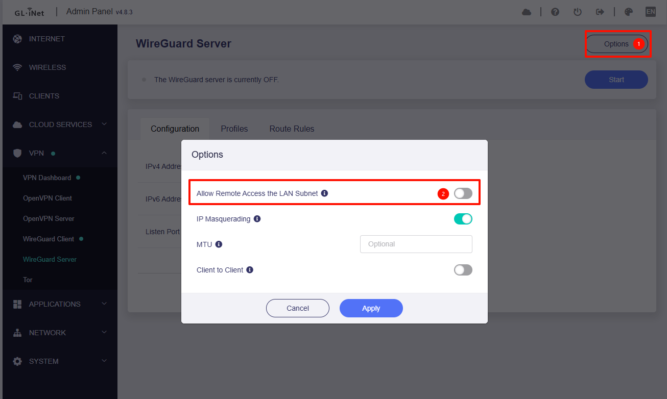

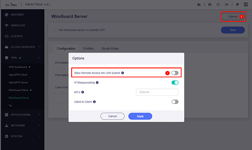

If you have enabled the 'Allow Remote Access the LAN Subnet' option, you can use the WG address or its LAN address to access the admin panel remotely while the WG is running.
However, if neither GoodCloud nor remote access is enabled, you will need to wait until you are physically present at the location of the server or have someone to access it.

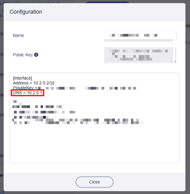

Thanks. Sorry for asking such obvious questions, but how do I find the address of the server?
I tried 10.20.0.1 and it did not load. I think that most likely I did not enable the remote access but would like to be sure as this would be really helpful in debugging.
If the client configuration file hasn't been modified, the server address should be found in the DNS field.
If the page doesn't load, remote access likely isn't enabled.
