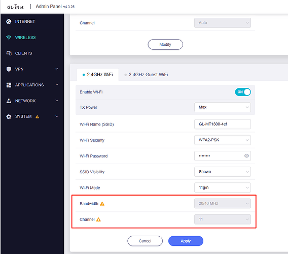

We have only restricted modifications to SSIDs within the same frequency band (2.4 GHz or 5 GHz).

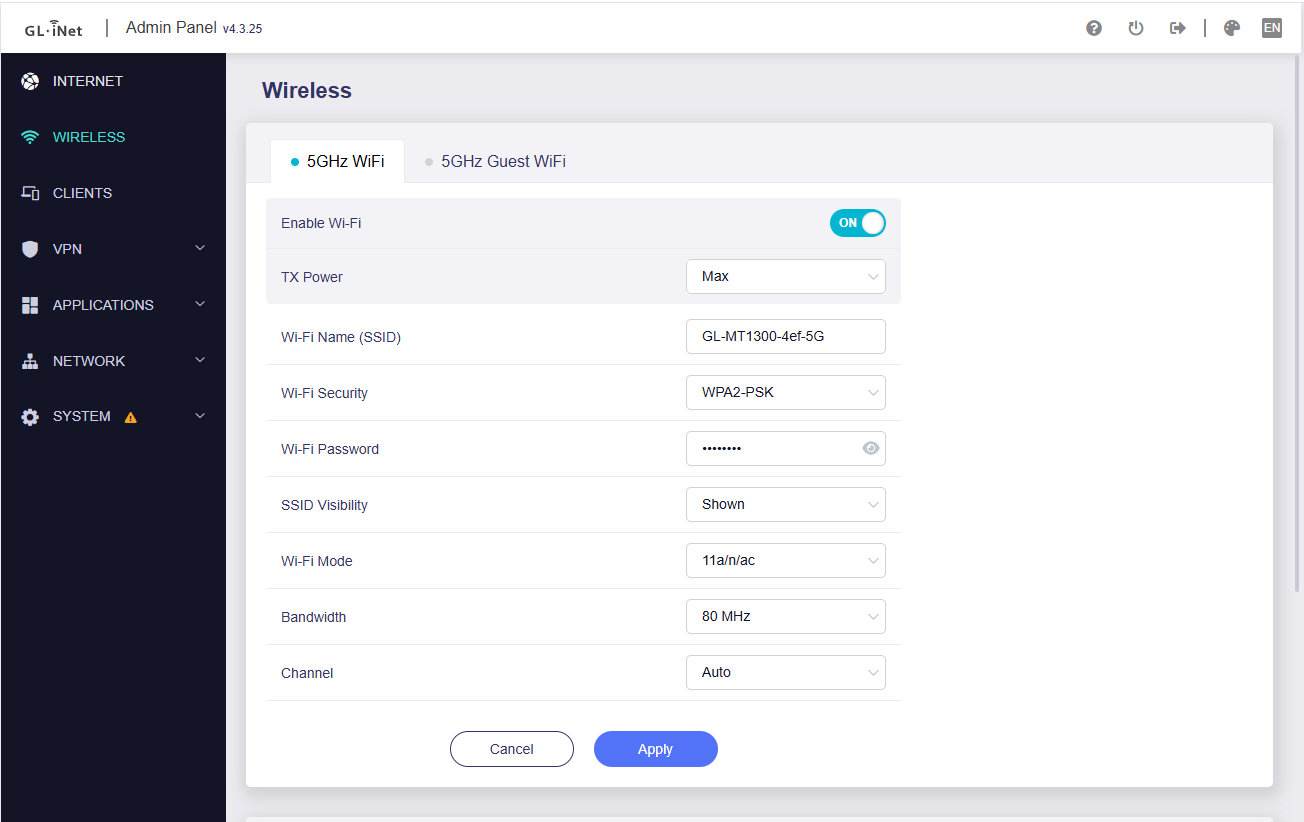

Therefore, if you are connected to the hotel’s 2.4 GHz Wi-Fi network, you should still be able to modify the channel of the 5 GHz SSID via the GL UI as shown below.
It is also possible to modify the channel via SSH/Luci, as we have not applied restrictions there. However, as mentioned earlier, this may lead to certain issues.
