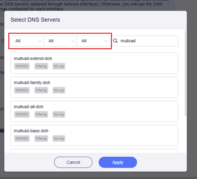

"https://base.dns.mullvad.net/dns-query" provides ad, tracking, and malware protection. Since the Beryl AX's GUI uses a different format for the string, I'm wondering if "mullvad-extend-doh" is the equivalent of "https://base.dns.mullvad.net/dns-query"?
Yes, I want to prevent not only the ISP, but potentially state actors like the government from spying on me. So both methods that we discussed earlier are secure and neither is necessarily better than the other?
Everyone has their own preferred provider.
So, just forget about Quad9 and use the DNS service provider that you like and suits you best.
mullvad-extend-doh equivalent to extended.dns.mullvad.net
mullvad-base-doh equivalent to base.dns.mullvad.net
If you want to use the mullvad-base-doh, please note that these options should be selected as 'All'.
