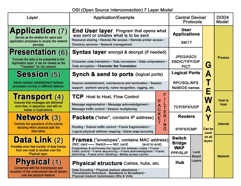

AI is telling me something about layer 2 routing is below the firewall so that’s why the rules i am setting may not work. Only by having a different subnet is layer 3 routing, and firewalls, getting involved. If that were true, why would the rules be an option in the UI? And I have read a number of forum posts where others were able to disable communication between devices on the same LAN. Is there some sort of workaround here that I may be missing? Has anyone else had this problem?
