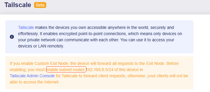

This is still an issue! I've spent HOURS trying to figure out why I can't connect to my home LAN after enabling Tailscale on the MT3000. The simple solution was to enable the firewall rules in the images in the first post of this thread. Why? Why is this necessary?! This should be handled automatically in the background, or at very least - make this a toggle in the main GUI so that I don't need to go into the LuCI settings!
To reach the internet via the exit node, enabling certain Subnet routes in the Tailscale Console is necessary.
Turning on masquerading on the tailsacle firewall zone also works, but it's not recommended since it'll introduce risk - the guest/wan network may use the Tailscale exit node.
