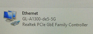

When I connect my laptop to the GL-A1300’s lan port the network adapter on the laptop displays the SSID on the bottom sticker of the GL-A1300. First it shows attempting to authenticate, then once its online it shows my device’s SSID. This is a clear give away and hint to that someone may be using a VPN. Does anyone know how I can fix this? I’ve already changed the SSID for my Wi-Fi and the Wi-Fi adapter reads that well.
The first time your windows connect to a WiFi network it record it as the network name, which bind with the MAC address.
Then later if it connect to the network that has the same MAC address it uses the old name.
You cannot update the name in the router side.
You have the update or remove the entry in windows registry.
I changed the SSID for the Wi-Fi and it updated in my Windows laptop for the network adapter, but why is the ethernet still showing the actual router SSID and all this info is coming from the same router?

Yeah, I thought of that also and tried it, but I’m just a standard user and cannot make any changes to device manager. I have another Slate Plus that has never been connected to this laptop. I’m wondering if I set that one up as the client instead, when it connects to the laptop for the first time if it will assign it the network name based off the default SSID or the one I set it to.
