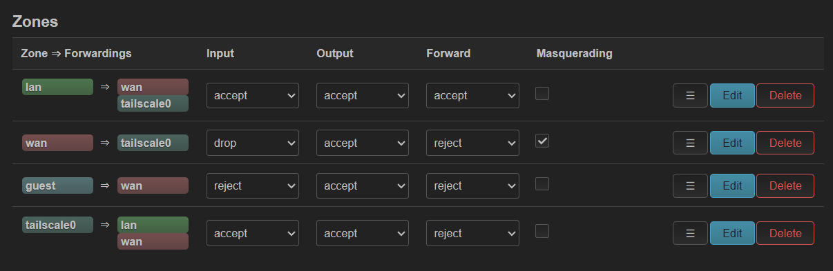

I read through the post you linked. Where do I apply those firewall rules?
These are my default settings in LuCI - should I modify “lan > wan” and “guest > wan” to drop/drop/drop?

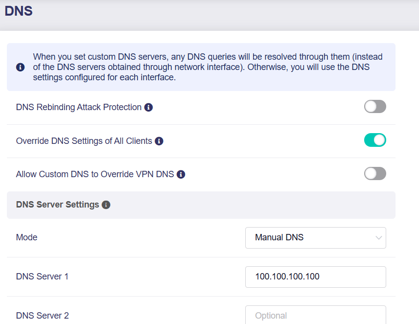

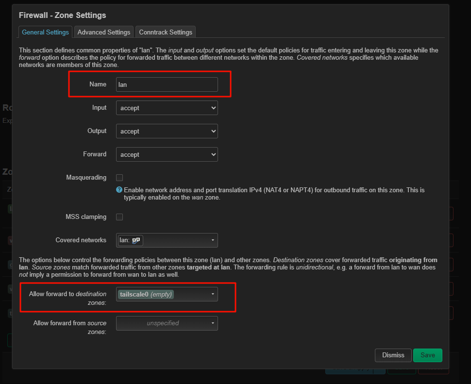

Removing the 'WAN' zone from the 'Allow forward to destination zones' list on the LAN/Guest Zone and setting the DNS to 100.100.100.100 should be enough.
Thanks. Made firewall changes with no problem, but setting DNS to 100.100.100.100 breaks my DNS
Forgot to mention that you will need to SSH into the router and execute the following command to allow Tailscale to accept DNS queries other than Magic DNS:
sed -i 's/--accept-dns=false/--accept-dns/' /usr/bin/gl_tailscale

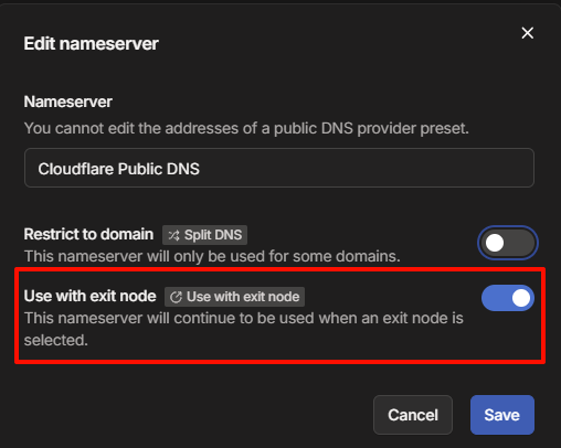

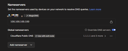

Please also make sure DNS is configured in the Tailscale Admin Console and that it is enabled for the Exit Node.
