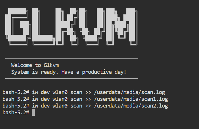

Access the terminal and run the following command 3 times:
iw dev wlan0 scan >> /userdata/media/scan.log -
Download the scan.log file from the virtual media
Please send the device logs and scan.logs file to this email address: Flora.wan@gl-inet.com
