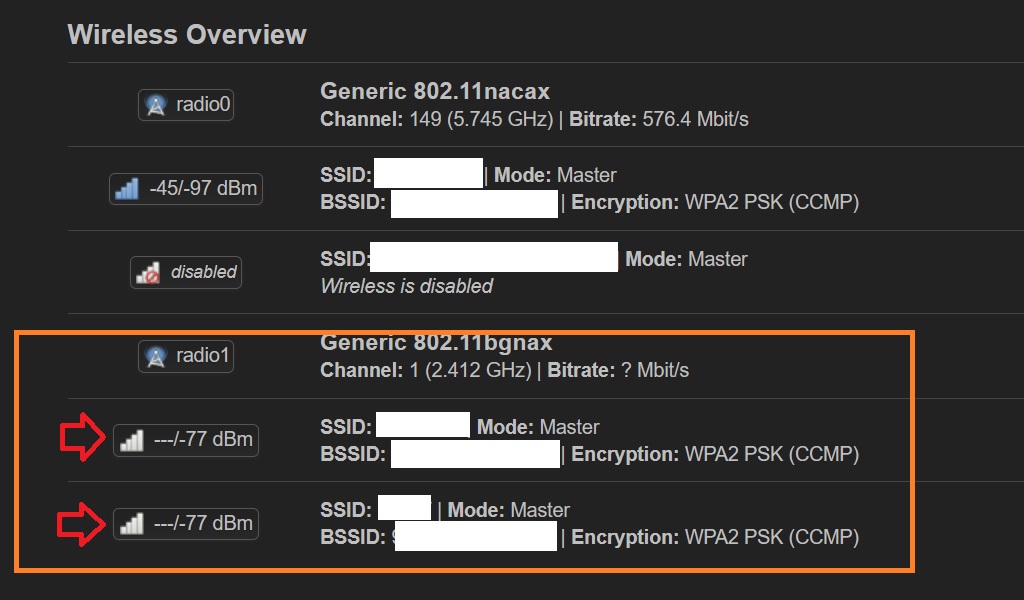

Recently, I realized that the 2.4 GHz Wi-Fi network is not working. Checking in Luci’s dashboard, I see that the radio interface is enabled, but the Wi-Fi signal is not colored

No relevant changes have been made to the router. It just stopped working.
Enabling and disabling does not work.
If anyone has any idea what might be going on, I would be grateful for help.

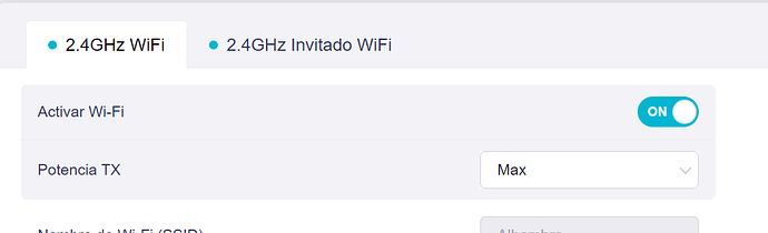

Do you have the gl-inet software installed? or did you flash to stock openwrt?
If the gl firmware is still there what happens if you log into it and go to wireless. Is 2.4 wifi showing on or off?

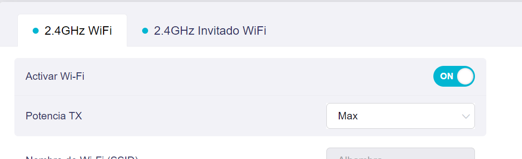

thanks @nktech1135 , yes I still have the Glinet software. When I go to the Dashboard I can see enabled the Wi-Fi button.
