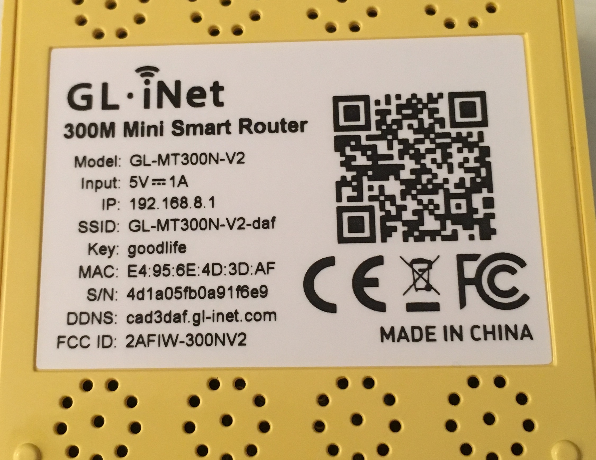

I tested all these units against this mango:

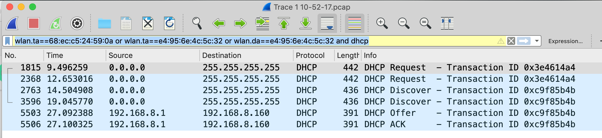

In Trace 1 10-52-17 pcap file, authentication starts around packet 1746 and the connection completes pretty quickly.
However, there is a long DHCP sequence…
The Chromebook’s requests are never answered. And it’s over 12 seconds for the mango to send a DHCP Offer after the Chromebook sent a DHCP DIscover.

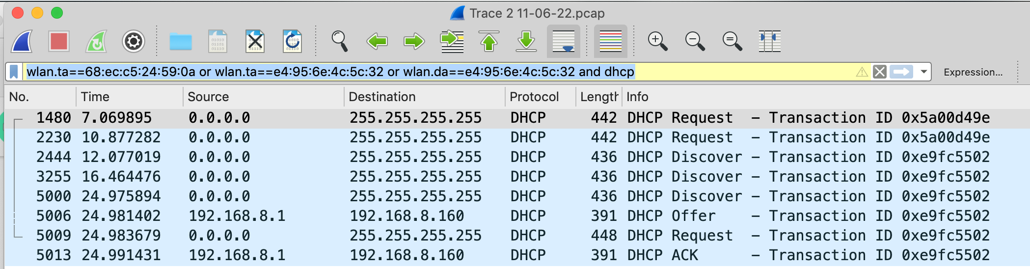

This happens quite a bit. Another sample with similar traffic and timing, Trace 2 110-6-22

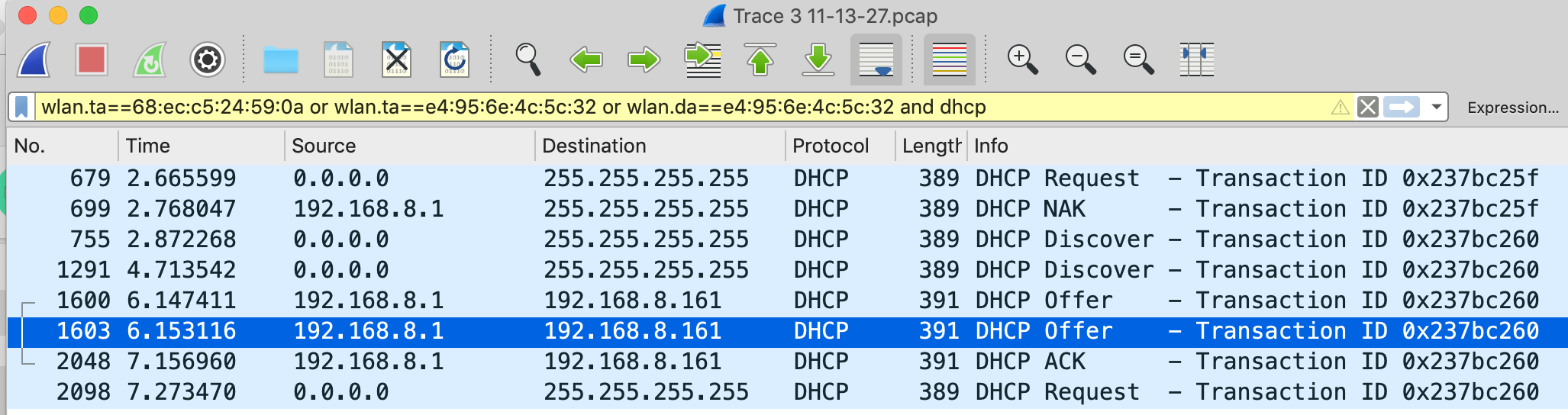

Now, I tried connecting on two other computers and see different DHCP activity:
Trace 3

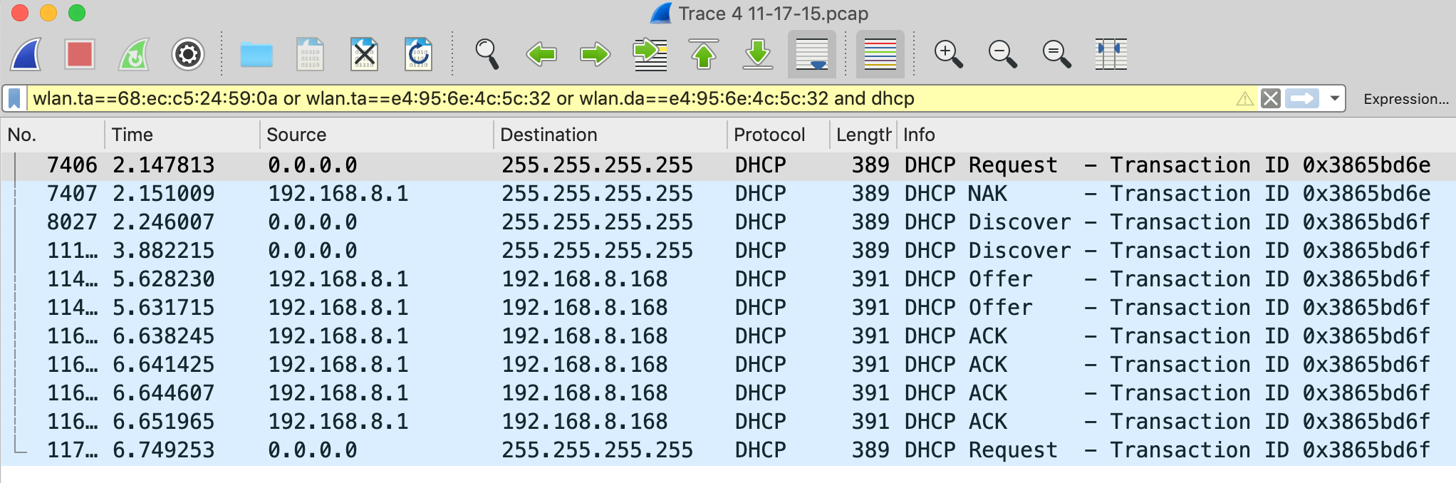

Another try (Trace 4 11-17-15) with a different computer that had had an old address from a different subnet, produced essentially the same result:
We can see that Requests can be NAK’d quickly, but DIscovers take a while to get a response. Is this normal?

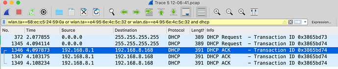

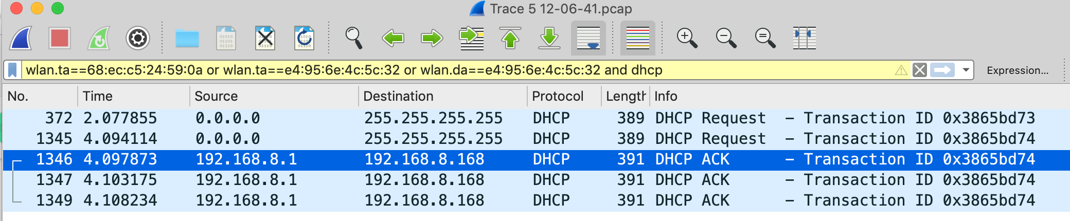

Once an address has been assigned (and the Request should not produce a NAK), things go differently (Trace 5 12-06-41)
The good news is that I can eventually get connected on an open network. Unless these are the expected DHCP response times, you might want to have a look in that area as well.

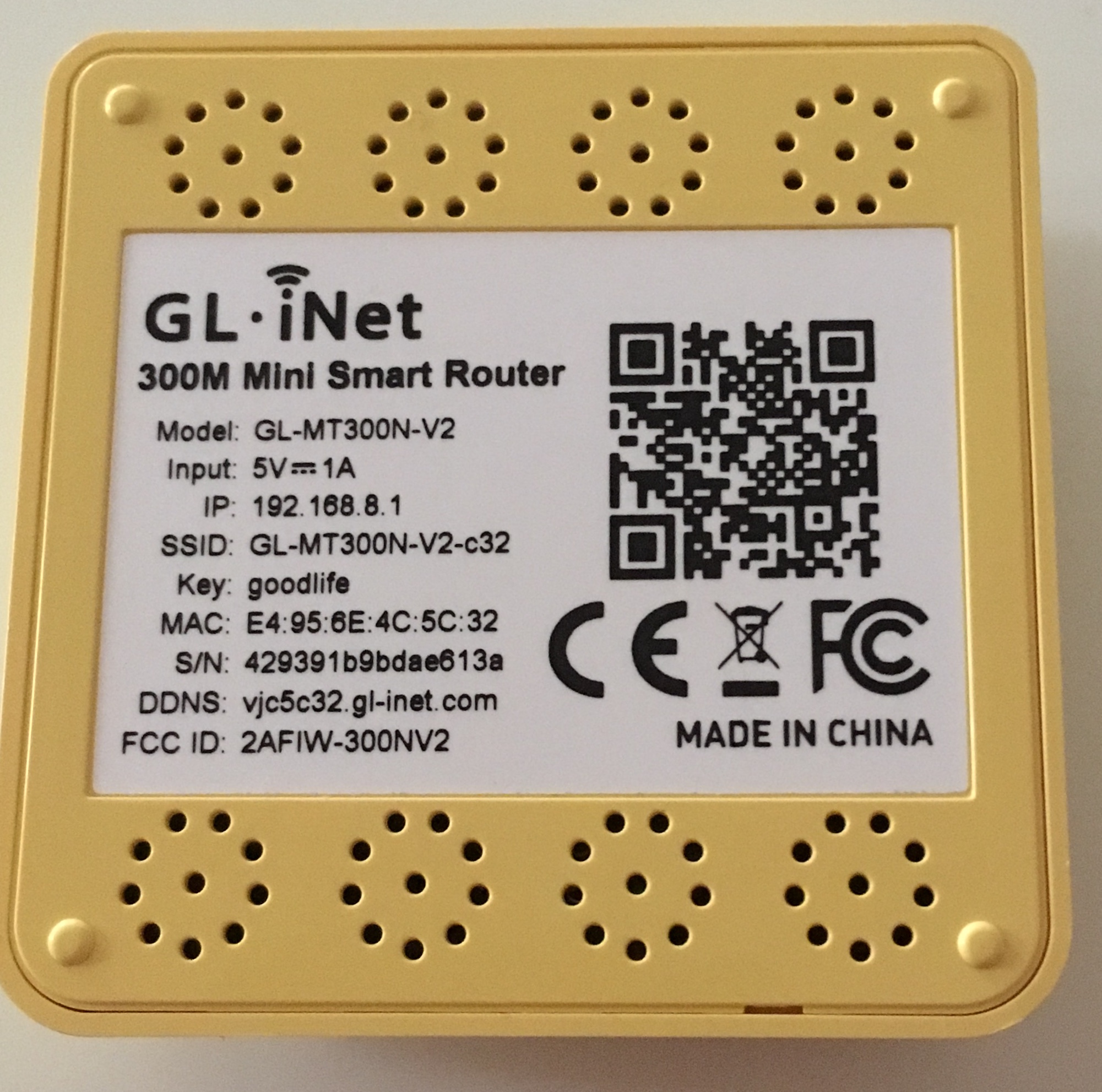

Sadly, I have no way to find out which chip is in the machine from the mac address (e.g. 68:EC"C5:24:59:0a).
