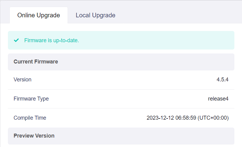

downgrade to version 4.5.2 and it will work normally again 4.5.3 and 4.5.4 have very annoying bugs like this one with wifi and also causing some random reboots, related to the kernel

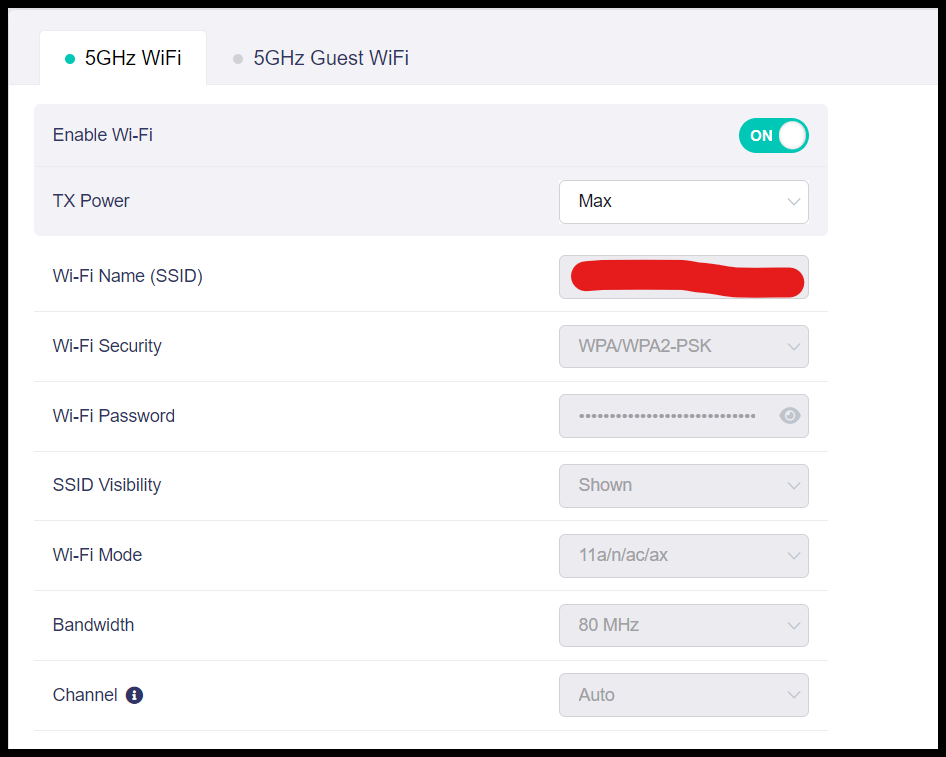

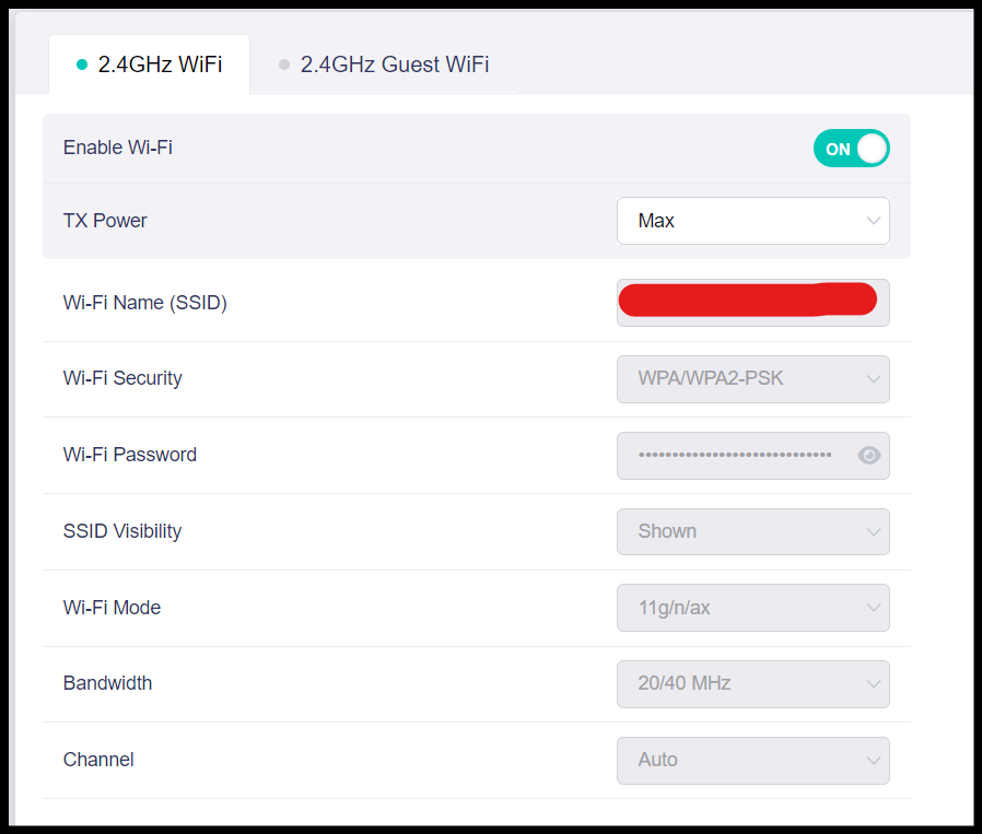

Using both 2.4 and 5 (with the same SSID name)

How do I downgrade the firmware?

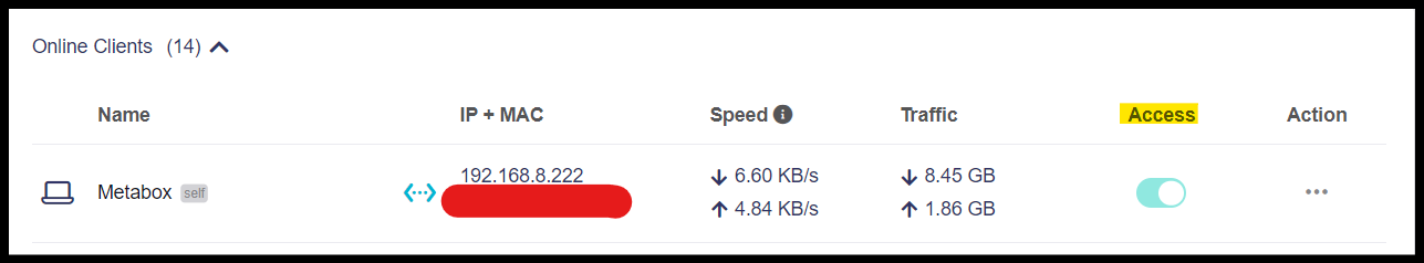

This morning the reboot of the Modem changed the “Blocked” to “Access” and I have to manually give access to all wifi devices connected.
The firmware is still the same, so nothing changed there how come this has changed?

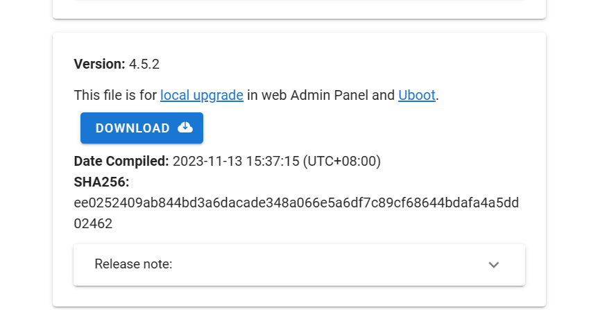

GL.iNet download center (gl-inet.com) Please download the firmware 4.5.2,And then install it manually.
