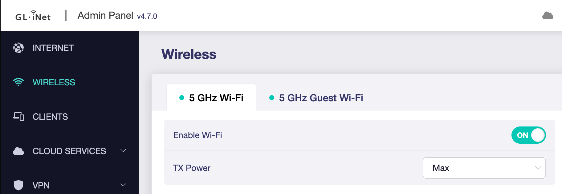

No Wi-Fi signal available, but it does say that Wi-Fi is up:
Screenshot of Wi-Fi

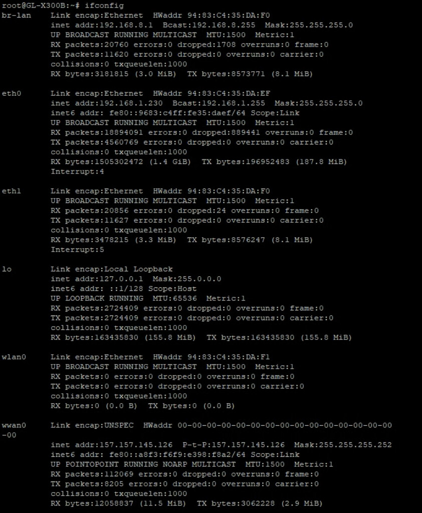

Also when this happens, can you ssh to the router and use the following command to check the wifi status
iwinfo
ifconfig

I then proceeded to try to connect to the Wifi, but was unable to find it. I then ran Iwinfo and got this:
Ifconfig produced this:
Any thoughts on this?

The RX power is only 7 dbm so seems it is a problem. Not sure why. You can move close to the router to see if it gets better.
