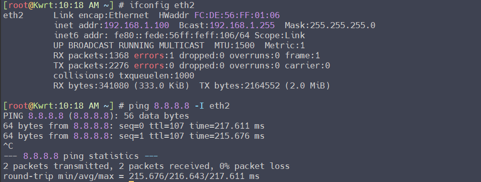

  2. What you provided is the openwrt router support list, SP-N150C4 is not a router, so it will not be in that list. The vanilla openwrt may not be pre-installed with kmod-usb-net-rndis by default. Please install this relevant module, re-plug to load the dongle, and create a new interface manually.
