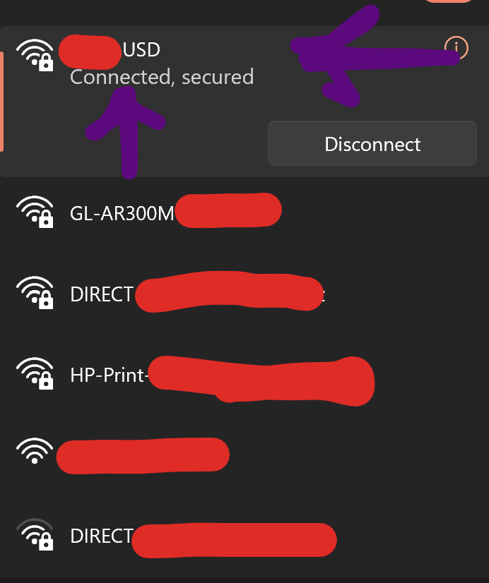

Hello! I just got myself an AR300M16 (Amazon link of the product I ordered) and sadly it can’t see the network. Am I supposed to be using the beta? Am I doing something wrong?? I tried to add it by clicking “Other” and picking “802.1x EAP/WPA2” but it doesn’t have a place for a CA cert (but that’s fine as our network doesn’t need one) and as soon as I click “join” the wifi point goes down and comes back up but no luck, still not connected. Please let me know what my next steps should be!
Small update: using the advanced config (Luci?) I was able to add the network manually (doesn’t show up on scan) but it doesn’t connect and the AP point for the router is now unavailable and not coming up so I have to use a wire. When I’m connect to my phones hotspot I can see the strength of the enterprise network connection changing but I didable my phone hotspot and the router doesn’t connect to the enterprise network and the AP is now unavailable. I did install wpad but that didn’t seem to do anything to help… I’ll try switching to the beta and see if that works. (Slightly busy so it might be awhile till I’m able to test the beta)
Just tried the beta and no luck!
(As seen all networks are printers, none are the one I’m looking for)
Pls don’t install wpad as it is already installed.
The default UI only support username and password. For CA you must use luci to configure.
Can you pls check what is the channel your EAP wifi is using? AR300M16 can only connect to 2.4G wifi, 1-11 channel by default.
Pls click the small info icon in your windows wifi connection and find out what is the wifi channel it is using.
For the CA if the default is set to none then it should be fine (if it’s set to the system CA then I will need to use Luci)
Just checked what channel the network is on and it’s on channel 100 (??) and it’s 5G… What should my next steps be? I have a CanaKit Wifi dongle can that help at all?

as your wifi is 5GHz. There are two ways to solve your issue:
  1. Set the wifi network to 2.4G if you have control.
  2. Choose AXT1800 which support EAP and 5GHz.
What other models support EAP and 5GHz (and channel 100) preferably on the cheaper side? Do GL-SFT1200 or GL-A1300 support these requirements?
A1300 support EAP. But channel 100 is DFS channel. Only AXT1800 is DFS certified.
