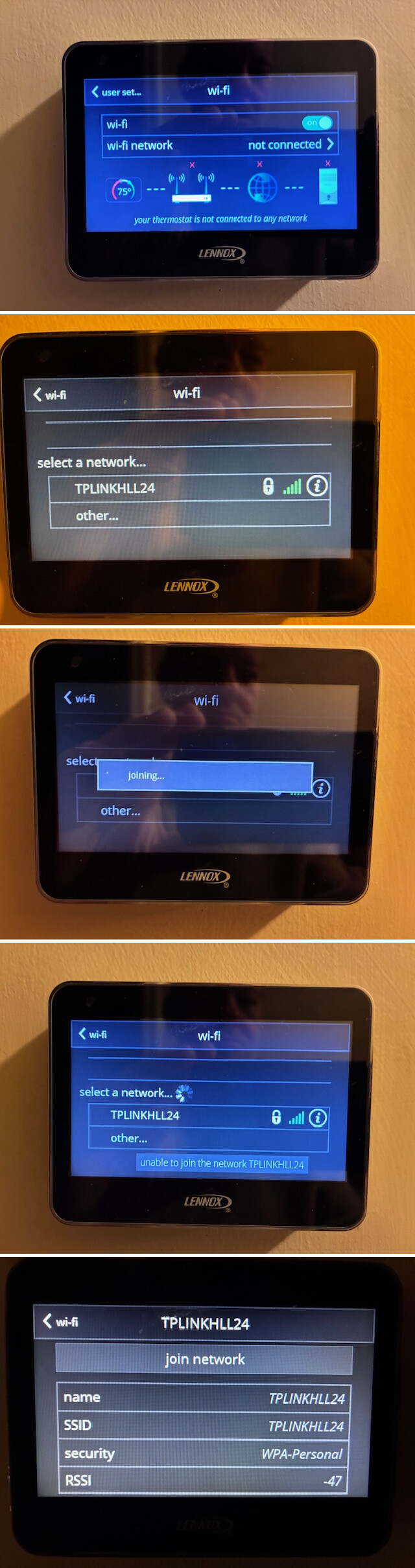

Additionally, this device seems to have a screen that can display connection-related information.
Could you share any error messages shown after attempting to connect it to Wi-Fi?

And the thermostat screen doesn’t provide much information but I’ve provided some photos of what it does share:
