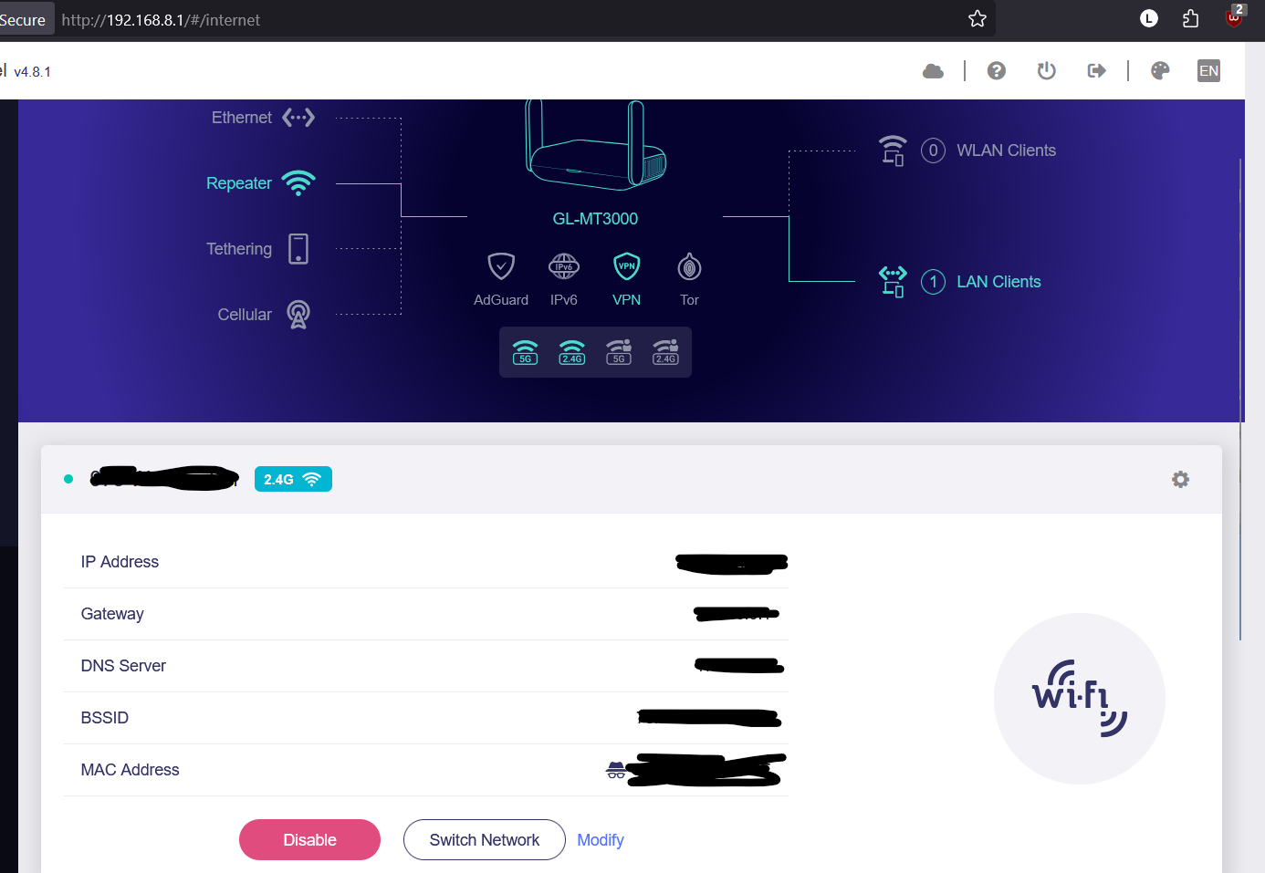

Hey, I'm new to this and could use some help
The specs I'm working with:
Firmware version 4.8.1
My router = Beryl / GL-MT3000
Connected to wifi as a repeater
Currently DNS on the beryl itself is set to Control D
Currently DHCP server is enabled on the beryl
My goal is to use the beryl as a wireguard VPN client -- I've set up a raspberry pi as a VPN server and I'm testing the setup from a different network, because I'd like to be able to connect to my home network from anywhere.

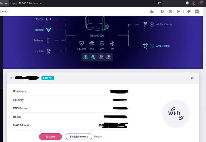

In the Admin Panel internet tab, it shows that the beryl router is connected to the internet. In the VPN dashboard, it shows that the VPN is up:
traffic statistics show 802 KB upload, 7 KB download speeds, so I am wondering if the reason I can't get an internet connection is because that is too slow to do anything useful.
Anyway, the main problem is that although the beryl router has an internet connection, I can't access the internet from any devices I've tried connecting to it by wifi or ethernet. The admin panel shows that the devices are connected and that the router has internet access, but the devices themselves say that the beryl doesn't have an internet connection
I went through the wireguard troubleshooting guide, and I'll document that below in a separate comment so this first post isn't horrifyingly long
According to the vpn dashboard, my server address and client virtual ip are NOT the same
My raspberry pi VPN server is connected to my home router, which I DID set up port forwarding for, and the endpoint port in the configuration file that I added to the beryl router matches the one that I added to port forwarding on my home router
My raspberry pi sever has a static ip address, so if I understand correctly that means I don't need a dynamic DNS address
I don't use spectrum and because the connection is working, that makes me think a blocked port isn't the problem
I'm testing from a separate network in a friend's house
The config file looks similar to the example one
I haven't explicitly set MTU under the interface section of the vpn config file, so I don't think that's the problem
Also, based on other forum posts I've seen, I tried turning on Override DNS Settings of All Clients and changed the DNS Server Settings mode to encrypted, but that didn't help.
Does anyone have any idea what might be set up incorrectly here? I appreciate any help!
