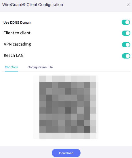

The QR code is automatically generated depends on the actual profile created by the server, the QR code and the content are correct.
Your feedback probably is a feature request, which means when you manage to create the profile in WG server, and it should be supported to add more customize configuration.

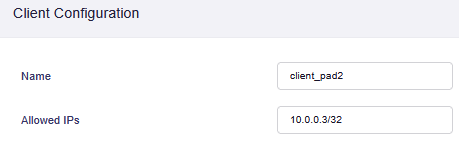

No. Again it is wrong. What is not to understand about this?
AllowedIPs = 10.0.0.3/32
is the server allowedips for that client, not the client allowedips for that server.
Currently, the implementation is the latter. I think it's okay being that way. All the exported options are for attributes of a client. Allowip can relate to many functions, but no need to make them all build upon it.
For "the server allowedips for that client", when we want to access the client's subnet from the server network.

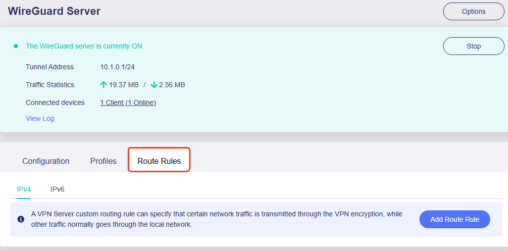

We have route rules:
4.8
4.7
They may be renamed for clearer and closer to the concept of allowips.
