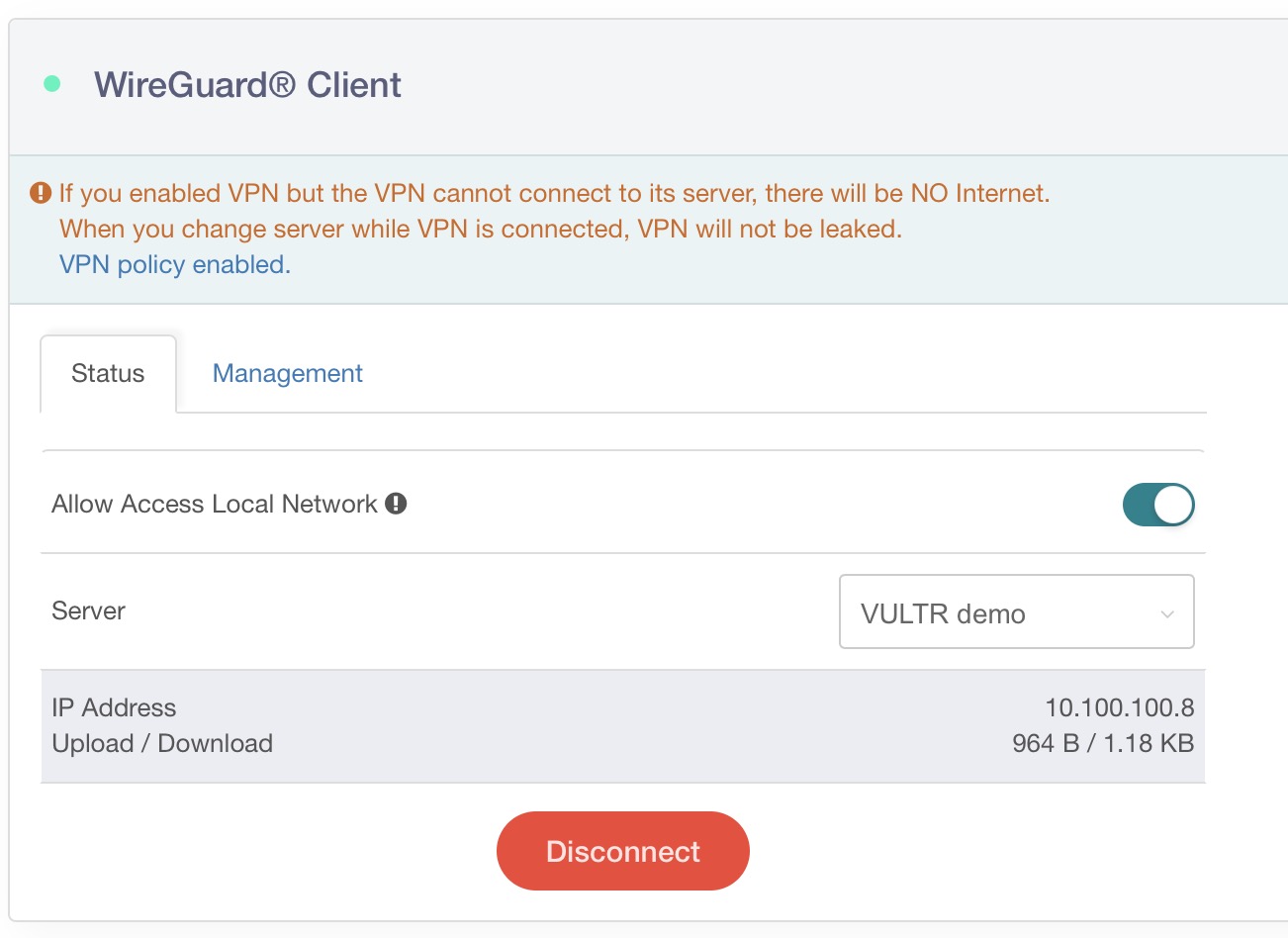

Do you have this turn on?
If yes you should not need to set up firewall and open ports
Thanks for your reply.

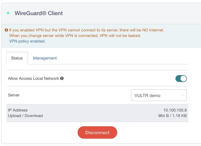

NO ! It was OFF
In attachment the screenshot of that.
Here below is the ping while I was connected with my laptop from home (X300B in office different internet connection/isp)
My laptop got IP 10.100.100.5
My server is 10.100.100.1
X300B is 10.100.100.8
ZBT WE826 running 19.07 stock using different ISP is 10.100.100.9

I then decided to (1) disconnect WIREGUARD in X300B, (2) switch ON “Allow Access Local network”, (3) delete rules in OPEN PORT IN ROUTER and reconnect WIREGUARD
As you can see
NOTHING changed.
Still unreachable…
