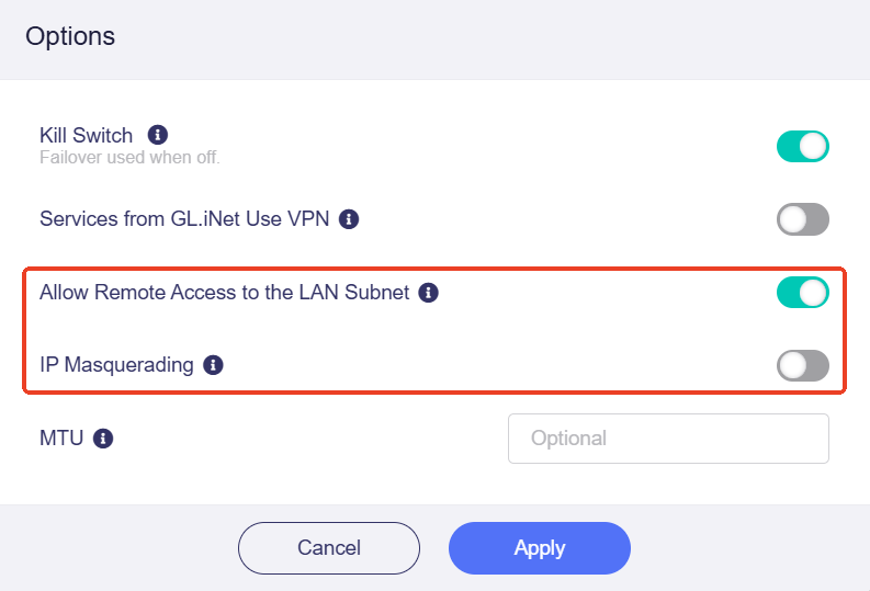

For now, we do not recommend adding the manual iptables rule yet. This command manually adds a NAT masquerade rule for traffic going out through the wgclient1 interface. This is similar to what the IP Masquerading option in the GL.iNet web interface is designed to do.

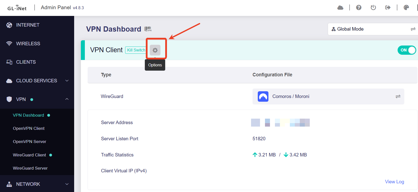

Could you please help check the following two settings on the GL-BE3600?

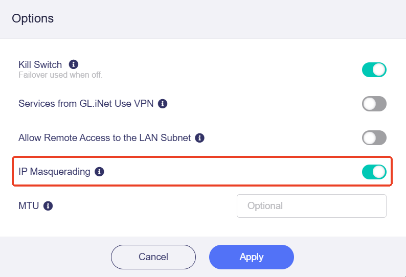

  1. Please go to the GL.iNet admin panel and open VPN -> VPN Dashboard, then click the gear icon next to the active WireGuard tunnel and check the IP Masquerading option.
    If you want to use the GL-BE3600 as a travel router, where devices behind it need to access the home LAN and use the OPNsense internet connection, IP Masquerading should usually be enabled.
    If you want a site-to-site setup, where OPNsense should see the real IP addresses of devices behind the GL-BE3600 and the home LAN should be able to access the GL-BE3600 LAN directly, "IP Masquerading" should usually be disabled and enabled "Allow Remote Access to the LAN Subnet"

  • IP Masquerading: Enabled by default (issue persists).
  • Remote Access: Enabled "Allow Remote Access to the LAN Subnet" (issue persists).
